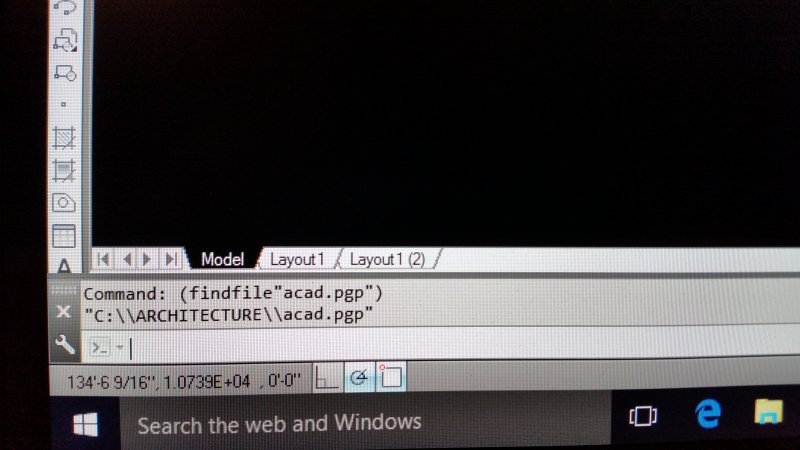

Hi Guys, Im having similar problems with my pgp file and dint want to start another thread about the same issue.
I am setting up two new computers to "behave" the way my other pc's do with the same (my own) pgp file designations.
The odd thing is that when I got to the tools tab, customize, Edit Program Parameters it opens my pgp file and all the commands that I use are shown the way I set them but when I try to use them they seem to revert to the original pgp designations/commands. For instance I re-set the C letter command to mean COPY and that's how it shows on the pgp file. But instead of giving me the copy function when I type "C" it now provides me with the Circle command/function which I think is its original setting. I've restarted the pc but to no avail.

If you have a acad.pgp file in C: \ Users \ "your user name" \ AppData \ Roaming \ Autodesk \ ACA 2016 \ enu \ Support, AutoCAD will always use that acad pgp.
This is how it works.
Command: (findfile"acad.pgp") then press the ENTER key.
AutoCAD will return the path to the correct file which will look similar to this.
"C:\\Users\\yourcomputernamehere\\appdata\\roaming\\autodesk\\autocad 2015\\r20.0\\enu\\support\\acad.pgp"

HI guys, thank you for your responses. Yesterday I was typing the findfile command with a space between the e and quotes, that made all the difference of course. as you can see from the images it is showing me where I have the pgp file, in a folder I call Architecture, how do I get this file to be the one cad uses. In the other picture you can see that in the Support File Search Path there is a folder I created called C:\acadpgp which has that particular file but it is not registering?
I just noticed that on this pc my friend did not set it up with an actual name, it just says "Office User" where "your Name" is, maybe that's throwing everything off?
Forget about Support File Search Path, just put your acad.pgp file here C: \ Users \ "your username" \ AppData \ Roaming \ Autodesk \ ACA 2016 \ enu \ Support.
Your acad.pgp file should not be sitting in the root drive of your computer dude. What were you thinking? And delete the path from the Support File Search Path while you're at it.
"I am a little confused since in the Support File Search Path there is no folder that contains or ends in the ...support\acad.pgp" designation?" It's probably because someone mucked around a bit too much without knowing exactly what they were doing and deleted the acad.pgp file from its original location.
