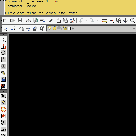

As an exercise in .NET Jigging, I created* a couple of routines that interactively produce parabolas.
The routine animated here constructs the parabola based on width and height.
Geometry created:
A geometrically precise, degree 2 spline.
The benefit of a spline versus the splined polyline version of a parabola is the ability to return accurate Perp and Tan osnaps during subsequent drafting operations.

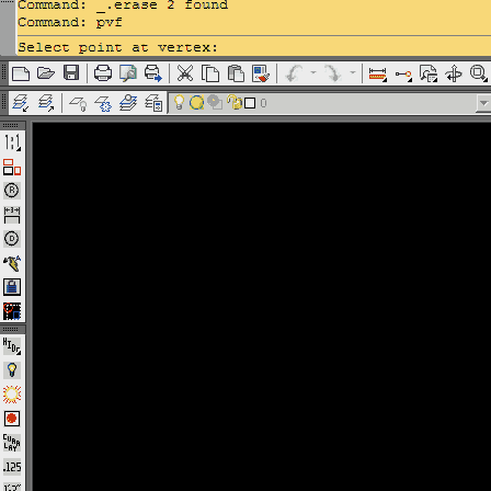

This animation demonstrates the routine that constructs a parabola based on a vertex, focal point, and width.
Geometry created:
Degree 2 spline with Point entity at the focus.
Link to post
The routines can still use a little work; specifically to allow a more intuitive direct distance entry. Still, I'm pretty pleased at how they perform (AutoCAD 2009).
Attached is the source code as well as a compiled dll if anyone is willing to give it a test drive.
All comments and criticisms would be greatly appreciated.
