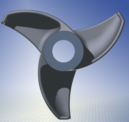

DaleLloyd7569 Posted April 7, 2009 Share Posted April 7, 2009 Hi I am fairly new to Inventor but have managed to figure out most problems I have run into myself. However I now need to model the impeller on the left of the attached PDF drawing and other than the main boss I really don't know where to start as it isn't a straight forward blade design. Any help on this would be greatly appreciated. Thanks Dale Impeller.pdf Quote Link to comment Share on other sites More sharing options...

shift1313 Posted April 8, 2009 Share Posted April 8, 2009 that should be a fun one:) it looks like you have some fairly planar cross sections to work with so thats nice. I would draw the 3 cross sections givent at their location in the plan view. Looking at your elevation view the lower edge of the impeller appears to be planar so i would create a plane, draw the top view and project it down onto that plane. You also have a nice reference in the elevation view for the cross section of the top of the blade. I would use all these in a loft operation. Id have to sit down and give it a shot later(cant right now) to see how this would all work out. Quote Link to comment Share on other sites More sharing options...

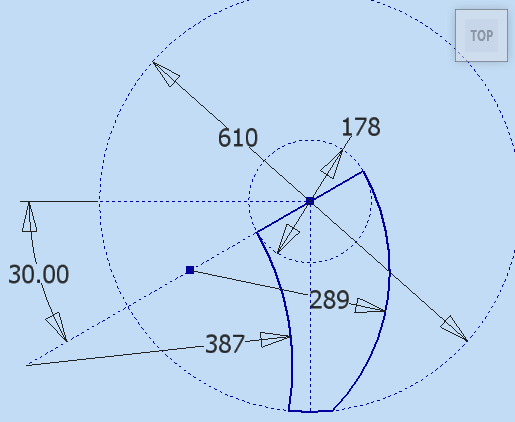

JD Mather Posted April 13, 2009 Share Posted April 13, 2009 Create a sketch on the XZ Plane as shown and then attach the file here and I can walk you step-by-step through a solution to the problem. Quote Link to comment Share on other sites More sharing options...

DaleLloyd7569 Posted April 14, 2009 Author Share Posted April 14, 2009 Just noticed your other post, just shows you should check all the replies and not just the one you get an email for. OK I have done the sketch as per your post, is it necessary to fully constrain a sketch because it still says it requires two dimensions which when I put them in don't seem necessary. Ignore the attachment to my previous post the correct one is here impeller.zip Quote Link to comment Share on other sites More sharing options...

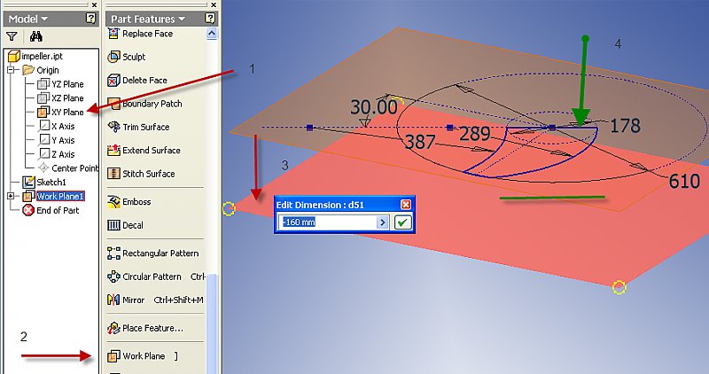

JD Mather Posted April 15, 2009 Share Posted April 15, 2009 I have a realy nice solution for you on this problem if you stick with me. In the last file you attached the Sketch1 turned color indicating that it is fully constrained. There are two Extrude features that should not be there. Delete those two Extrude feathures. The next step is to create a Workplane offset -160 from the XY Plane. (see steps 1-3 in attached) Then start a new sketch on the offset workplane and Project Geometry the line indicated in step 4 in attached image. Let me know when you have completed these steps. Quote Link to comment Share on other sites More sharing options...
DaleLloyd7569 Posted April 15, 2009 Author Share Posted April 15, 2009 OK I have done those steps Quote Link to comment Share on other sites More sharing options...

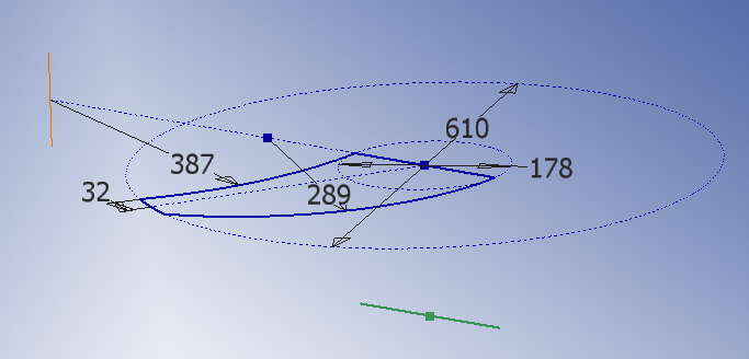

JD Mather Posted April 15, 2009 Share Posted April 15, 2009 Now, Create a WorkAxis through the center of the R387 arc. You can do this by selecting WorkAxis and then clicking on the endpoint of the construction line and the perpendicular sketch plane (I believe your sketch was on the XY Plane). Quote Link to comment Share on other sites More sharing options...

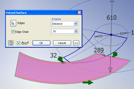

JD Mather Posted April 15, 2009 Share Posted April 15, 2009 Click OK and you should have a yellow or orange translucent surface. Select Extend surface and then click the three edges to extend as shown below. Set the extend distance to 10. Let me know when you have completed this step. Believe it or not - you are almost done. Quote Link to comment Share on other sites More sharing options...
DaleLloyd7569 Posted April 16, 2009 Author Share Posted April 16, 2009 OK All done Quote Link to comment Share on other sites More sharing options...

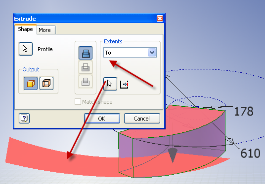

JD Mather Posted April 16, 2009 Share Posted April 16, 2009 Now Extrude - To the surface. Then right click on the surface in the browser and turn off the Visibility of the surface. Quote Link to comment Share on other sites More sharing options...
