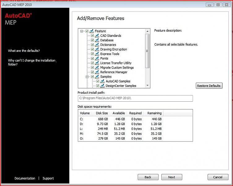

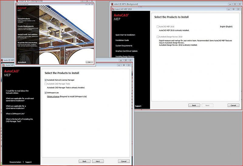

reinsert the CD and do an 'Add Features' and install the AutoCAD profile, which is the "classic" autocad profile.
hey Styke, this work for MEP too?
No, don't use the installer. Keep the disc in, go to the Control Panel and Add/Remove programs (or Programs and Features if you have Vista). Go to the AutoCAD MEP, highlight it, and hit the Uninstall/Change button. Then click the Add or Remove features. :)
