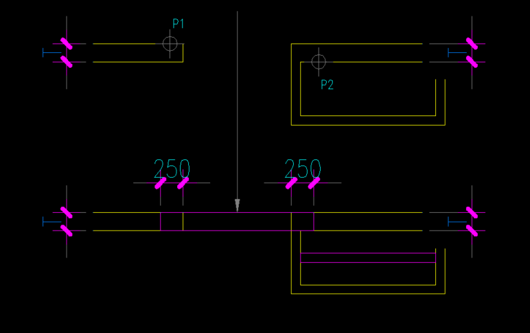

Help me Draw Rectang by two Points P1 and P2
Hello
P1 and P2: Will they always be indicated in the drawing with two x-shaped lines?

@Steven P,
I think the @Mountain_XD want to draw a rectangle between two selected points in that way the rectangle will be drawn inside the yellow polylines (I think that is walls) at desired height (T) in total length between two selected points. I think I understand correctly based on drawing.

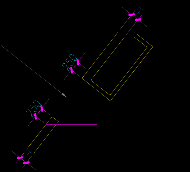

Thanks to GLAVCVS, Steven P, Saxlle, Nikon, BIGAL for responding to help me, but you misunderstood my intention, the purpose is to draw the lintel by expanding the window to select through two points p1 and p2. The yellow line is the wall, T is the wall thickness, the purple line is the rectangent to draw, that is the lintel beam, the value 250 is entered by the user. The lintel thickness is equal to the wall thickness. I have attached a new file. Please help me fix the code. Thank you very much.

That is what I was suggesting, you can get an end point by just pick near it. Then add the 250 offset and work out the points. Just posted a similar answer at another forum. If you use plines for the yellow wall need to add some more code to get to same point.
