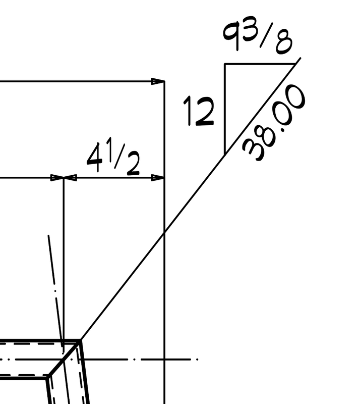

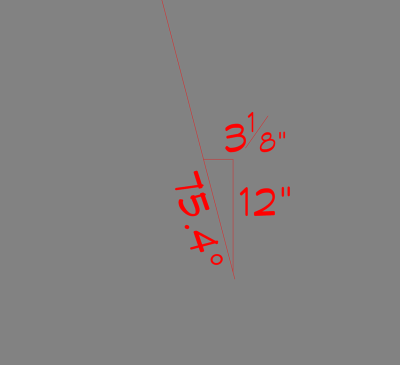

Cadkiller Posted April 5 Posted April 5 Hello Group, It's been a long time since I posted anything on this forum. I searched for this topic but didn't find anything to help me create it. I'm trying to create a bevel symbol which will give the sloped/pitch info for a selected line. Based off of 12" run and give the angle as well. Any help would be greatly appreciated. Sincerely, Edward Borg www.precisiondraftingllc.com https://www.facebook.com/MiscIronDetailer/ 40 Plus Years of Steel Construction Experience Quote
BIGAL Posted April 5 Posted April 5 (edited) A good task to start learning lisp. Select a line (entsel Get X & Y of start and end points, work out X & Y, work out X rescaled to Y = 12 (entget (car (entsel Ask for a point or hard code a distance away use (polar pt ang dist)& (getpoint Draw the 3 lines (command "line" Draw the text. (command "text" Its not very hard so I would ask others to not post code, at some point learning how to do a simple lisp task is well worth while. So have a go plenty here can help when you get stuck. Edited April 5 by BIGAL Quote

Cadkiller Posted April 6 Author Posted April 6 Plus, I would like the label to be dragged afterwards for placement with the line extension being adjustable. So, the label will be placed outside the line (like my image) and not centered like yours does. Quote

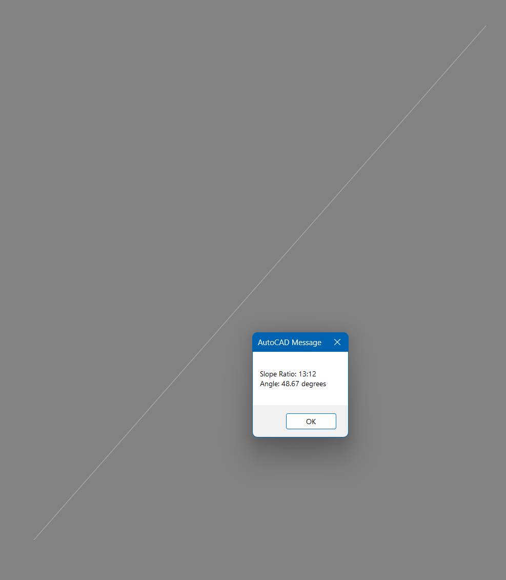

Cadkiller Posted April 6 Author Posted April 6 (edited) On 4/5/2025 at 7:24 PM, Tsuky said: Okay I tried to modify the code with AI to base the ratio on 12 and got the following results. This line happened to be greater than 45 degrees, so the result is greater than 12 versus swapping the base of 12 from horizontal to vertical. Plus, it just gave me the results instead of providing a label to place. Here is the code it gave me. (defun C:SLOPE ( / blp pt_o pt_f frac_prec sv_osmd e_last dxf_o slope slope_h slope_v nx sv_ortho pt_start pt_x t2_slope t1_slope pt_mid pt_text pt_int ed_1 angle) ;; Turn off command echo and blip mode (setvar "cmdecho" 0) (setq blp (getvar "blipmode")) (setvar "blipmode" 0) ;; Get start point (setq pt_o (getpoint "\nSpecify the starting point: ")) (cond (pt_o ;; Get end point (setq pt_f (getpoint pt_o "\nSpecify the ending point: ")) (cond (pt_f (command "_.undo" "_group") ;; Set fraction precision (setq slope_v 12) ;; Fixed as 12-inch run for imperial standard ;; Get slope ratio (setq slope (abs (if (zerop (cadr pt_f)) 0.0 (/ (- (cadr pt_f) (cadr pt_o)) (- (car pt_f) (car pt_o))))) slope_h (fix (* slope_v slope)) nx (if (zerop slope_h) 0 (gcd slope_h slope_v)) ) ;; Simplify the ratio using GCD (while (> nx 1) (setq slope_h (/ slope_h nx) slope_v (/ slope_v nx) nx (gcd slope_h slope_v)) ) ;; Calculate angle in degrees (setq angle (atan slope)) (setq angle (* angle (/ 180.0 pi))) ;; Convert radians to degrees ;; Display slope ratio and angle (alert (strcat "Slope Ratio: " (rtos slope_h 2 0) ":" (rtos slope_v 2 0) "\nAngle: " (rtos angle 2 2) " degrees")) ;; Add other functionalities, like symbol creation and text placement, here. ) ) ) ) ;; Restore blip mode and command echo (setvar "blipmode" blp) (setvar "cmdecho" 1) (prin1) ) Edited April 7 by SLW210 Added Code Tags!! Quote

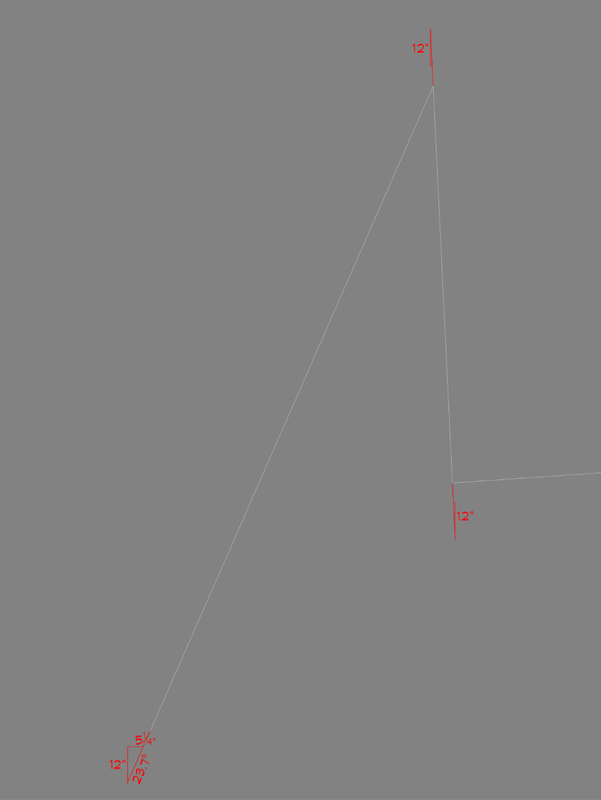

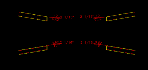

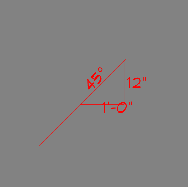

BIGAL Posted April 11 Posted April 11 I have done something and it looks at the 4 quadrants, the problem I have before I go any further is I need a real dwg as I need to match text styles etc. Can you please post one with before and after. Will fix dim on outside and offset from line work. Quote
Cadkiller Posted April 11 Author Posted April 11 Hi Bigal, Thanks for taking the time to help me with this. I greatly appreciate it! Not sure what you mean about before and after. I have attached a rail detail with and without these bevel labels. I see yours has the hypotenuse instead of the angle and the scale and text size seems to be off. Can the triangle be smaller and the text be bigger and the placement of the text be slightly off the line? Similar to how my initial image showed. Would it be based on the current scale and text style? Sincerely, Edward Borg www.precisiondraftingllc.com https://www.facebook.com/MiscIronDetailer/ 40 Plus Years of Steel Construction Experience R_4(R1).dwg R_4.dwg Quote
BIGAL Posted April 12 Posted April 12 Ok can see need to be 4" line with correct 12 as label understand, can do. the 3rd value is internal angle. Watch this space. Just a comment something wrong with label here are you manually drawing rather than say strcat two texts together ? Can do a lisp etc enter prefix enter suffix. 1-hss4 is result. Just have a custom text command. The prefix is remembered change at any time. Quote

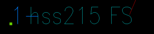

Cadkiller Posted April 12 Author Posted April 12 Big Al, I’m not sure I understand. These drawings were created with SDS2 and the material is hyperlinked which is probably why the part mark is coming out of the selected linework. I probably should just sent you an AutoCAD drawing instead. Quote

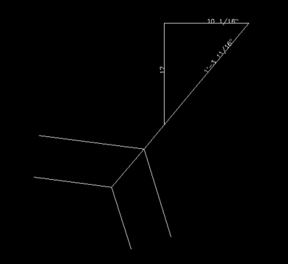

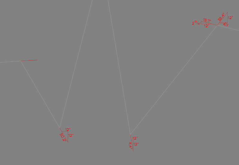

BIGAL Posted April 24 Posted April 24 (edited) Give this a try pick end of line etc near where label is to appear, when asked. Code removed updated in later post. Edited April 27 by BIGAL Quote
Cadkiller Posted April 25 Author Posted April 25 Hi Big Al, I just tried your lisp and got the following error. Command: _appload Bevel-Label.lsp successfully loaded. Command: AutoCAD variable setting rejected: CLAYER "User_annotation" Command: Command: bevel AutoCAD variable setting rejected: CLAYER "User_annotation" Any idea why I'm getting this and how to fix it? Quote
BIGAL Posted April 25 Posted April 25 Remove this line (setvar 'clayer "User_annotation") set to what layer you want answer drawn on before running, the error may be that the layer does not exist. If you nominate a layer to be used can be added. I have updated the code above, so copy again, found a little bug to do with heights that were whole numbers and no fractions. Quote
Cadkiller Posted April 25 Author Posted April 25 Hey Big Al, I tried creating that layer and also try changing it and neither one worked. I get the same error message. Quote
