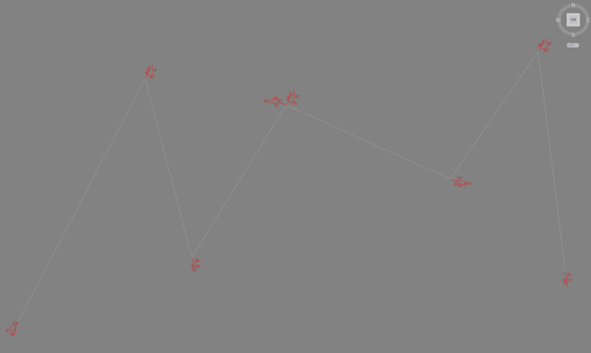

Can you post me a sample of the bevels use wblock. I tested on random lines and it worked, all 4 quadrants. That is all that is needed some lines.
Here is a drawing with some lines and the bevel symbols that are just made from lines and dimensions.
Which I created with a wblock as requested.
I hope this is as you requested,

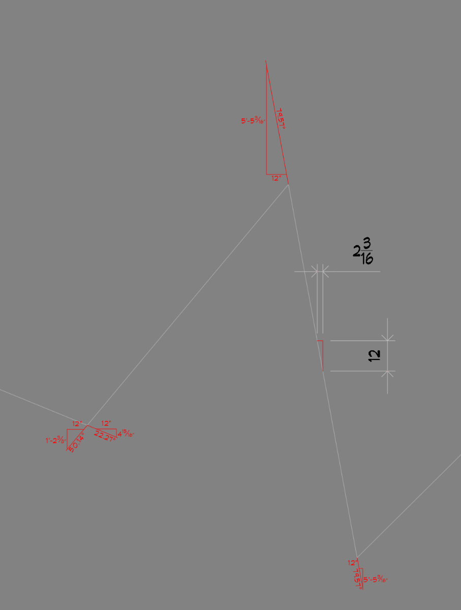

Hey Big Al,
Very nice!
1- That the 12" is always horizontal.
Can it be vertical to display the horizontal less than 12"?
Where the 5'-5 3/16" would be 12" and the 12" would be 2 3/16".
2- Could the text height be set to match the current scale?
Or if not, could it the set to 1 1/2" scale versus what it is now?
3- Lastly could the triangle size be constant or does it need to vary based one the angle?
Thanks again you are the Awesome!

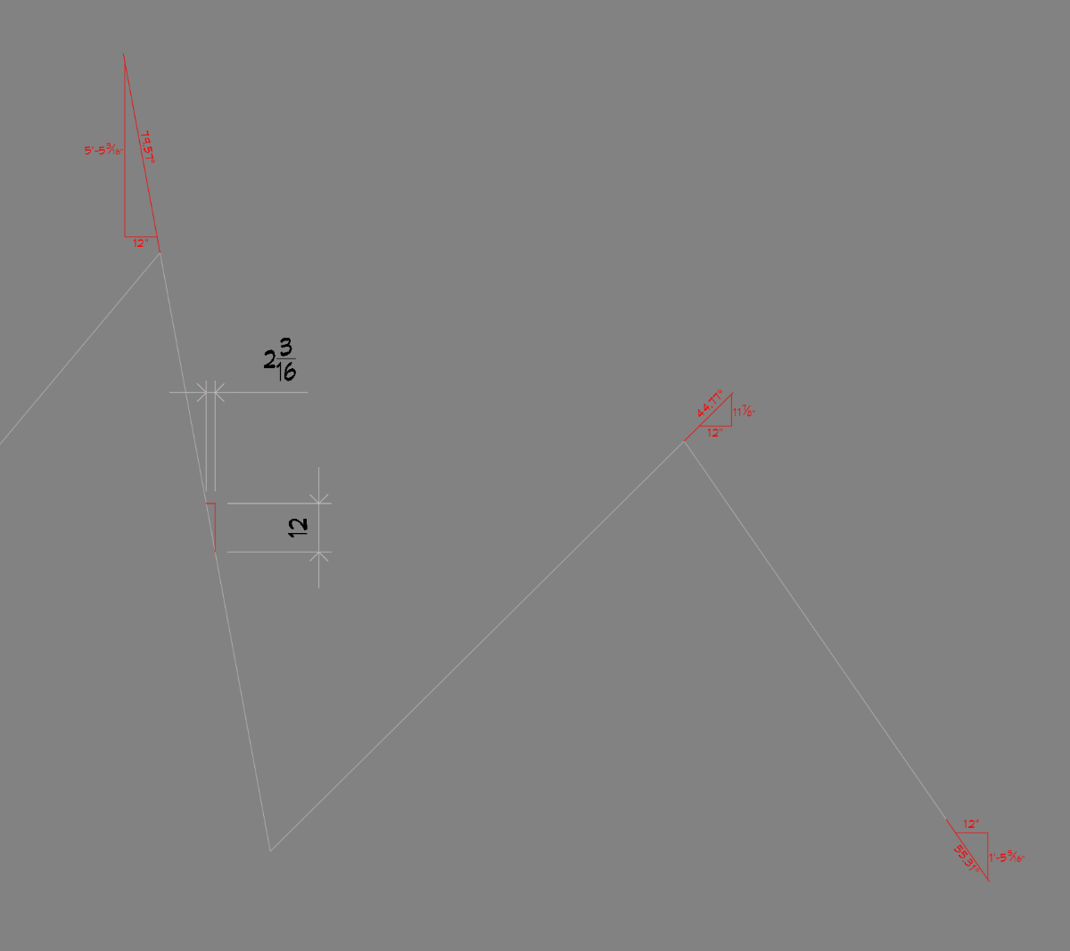

Hey Big Al,
It's still not applying the 12" as vertical, but the size of the triangle is much smaller.
Top answer is odd will look at that. will have another go
Al
The top answer was from the previous code you created.
Sorry I should have removed it.
The lower right one is from the latest code.

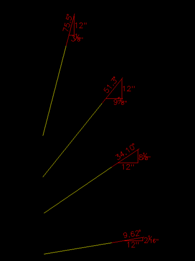

Working on it the issue is you need to reverse the 12" to the other leg when an angle exceeds 45 in any quadrant. So 0-90, the horizontal will be 12" when angle is less than 45, when it exceeds 45 it changes to the vertical.
So I have 4 quadrant defuns need to change this to 8. Will try to do soon.
Thanks, Big Al
Look forward to seeing it once you get a chance to complete it.
i am working on it you can see the swap of the 12". Maybe tomorrow.

Big Al,
You are the best!
Thanks so much for this code!
I owe you one.

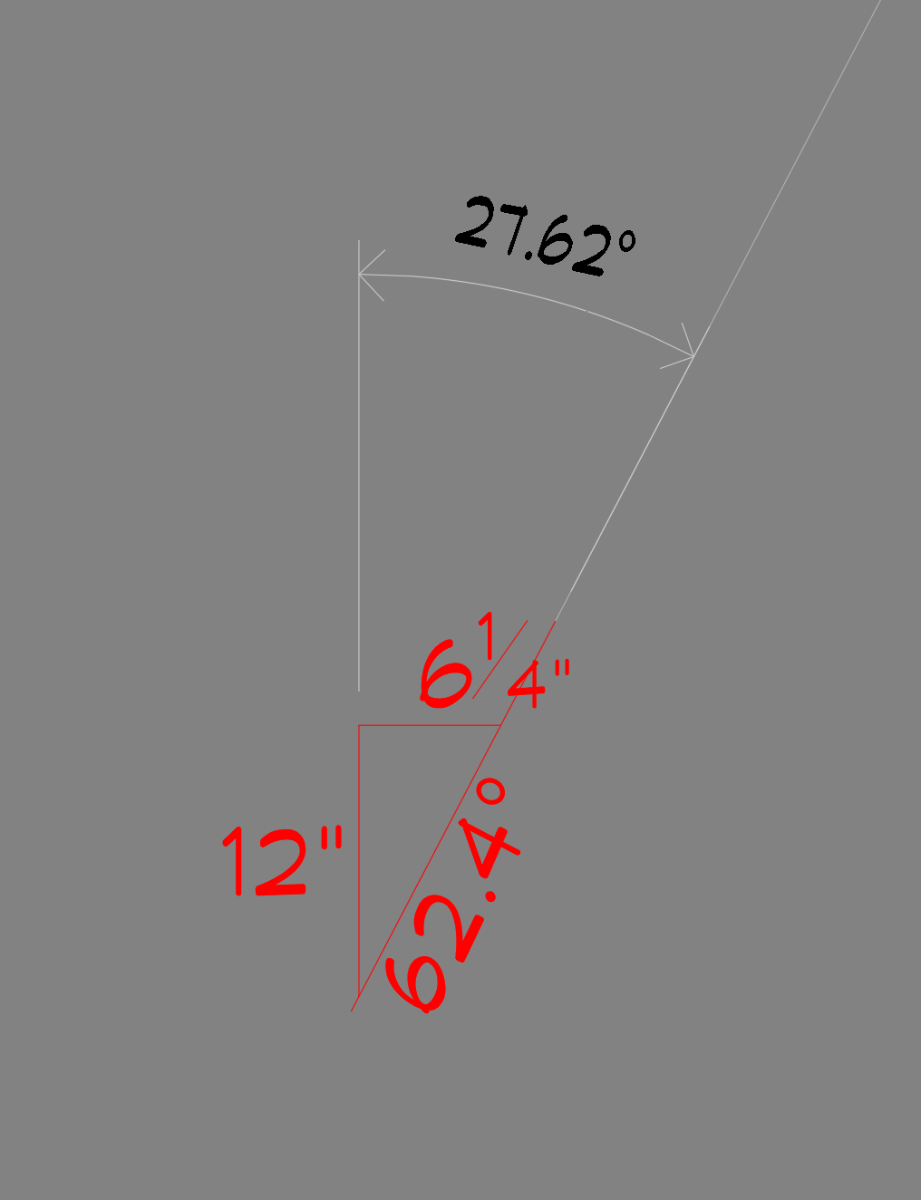

It works great!
Opps I spoke too soon!
I see when the 12" base is vertical the angle is showing the opposite answer.
Is it easy to give the reverse angle of the pitch?
