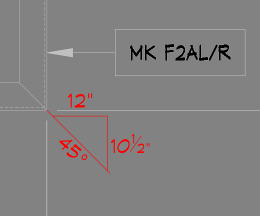

Cadkiller Posted May 22, 2025 Author Posted May 22, 2025 Hey Big Al, I tried your lisp code and noticed something is wrong with the bevel answer. This line I'm labeling is on a 45-degree angle, but the vertical answer is 10 1/2" and it should be 12". Quote
BIGAL Posted May 22, 2025 Posted May 22, 2025 I will check the less than greater than check, sound like its wrong I know it worked at 47 degrees during testing. Quote

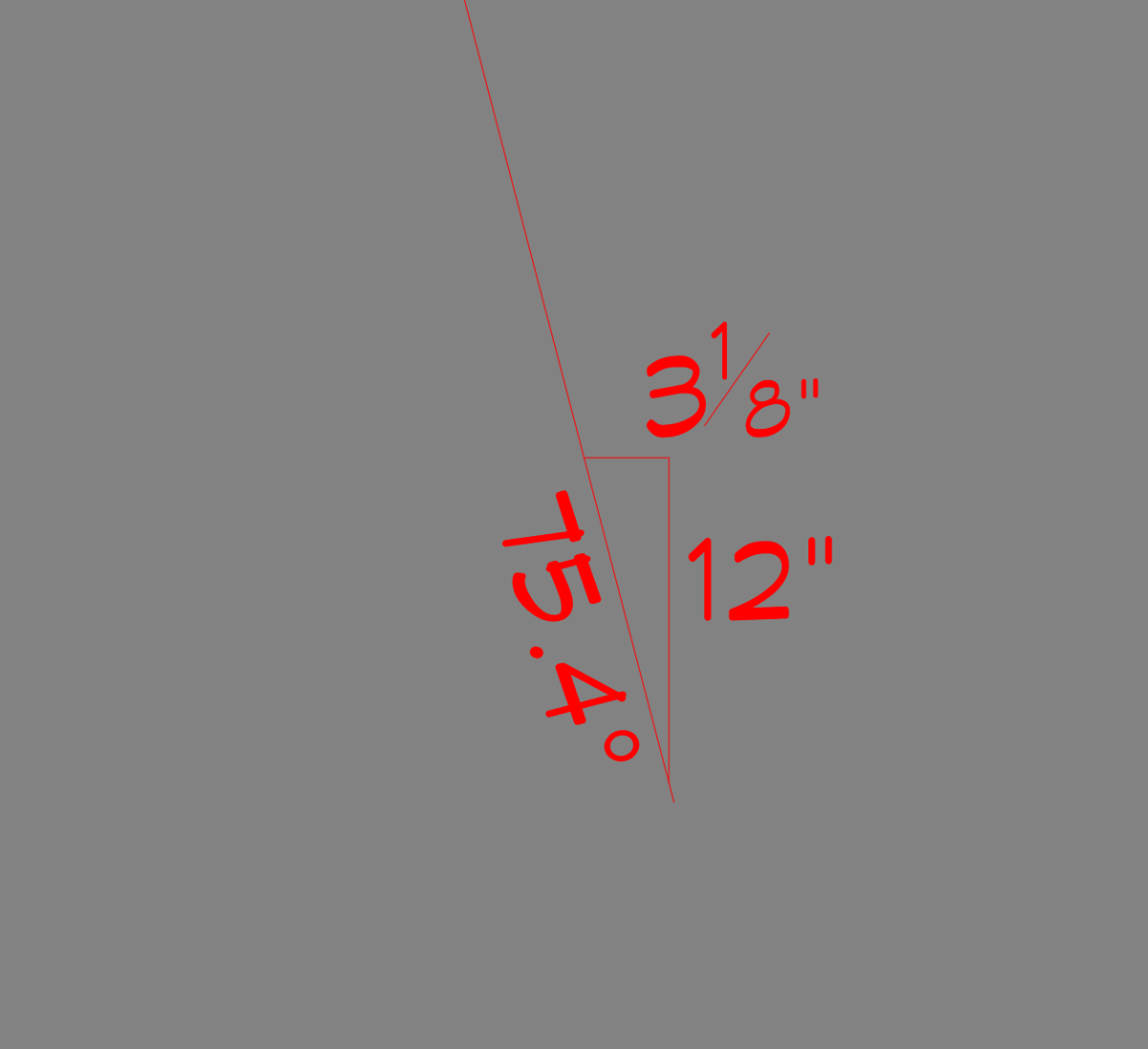

Cadkiller Posted May 26, 2025 Author Posted May 26, 2025 Also, the angle is still the same as previous. Instead of giving the smaller angle (14.6) it gives the larger one (75.4). Quote
BIGAL Posted May 26, 2025 Posted May 26, 2025 (edited) Ok missed that angle why not have a go. in the defuns look at the ones that are greater than 45, then the correct angle must add up to 180.0 so (- 180 angt 90) you have to work in radians. (rtos (- (/ pi 2.) angt) 2 1) The 1' comes from the dofrac it gets 11.999999 inches so it makes it to 1' could add another check if "1'" then use 12". Edited May 26, 2025 by BIGAL Quote

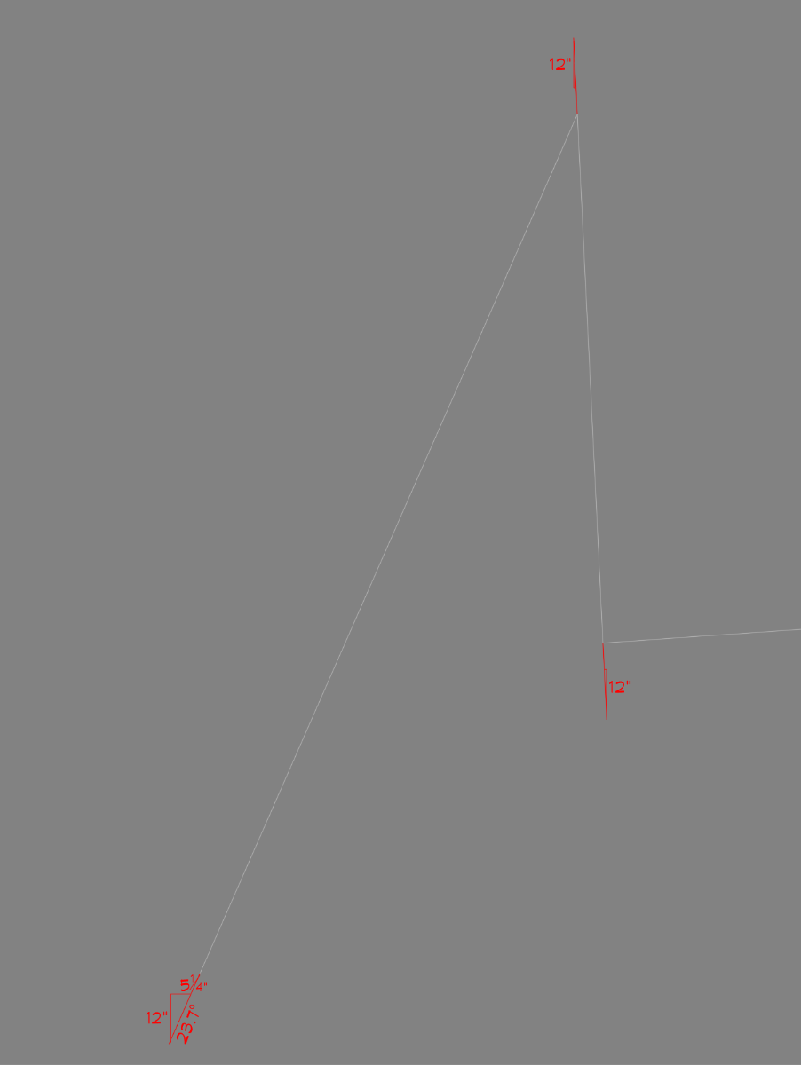

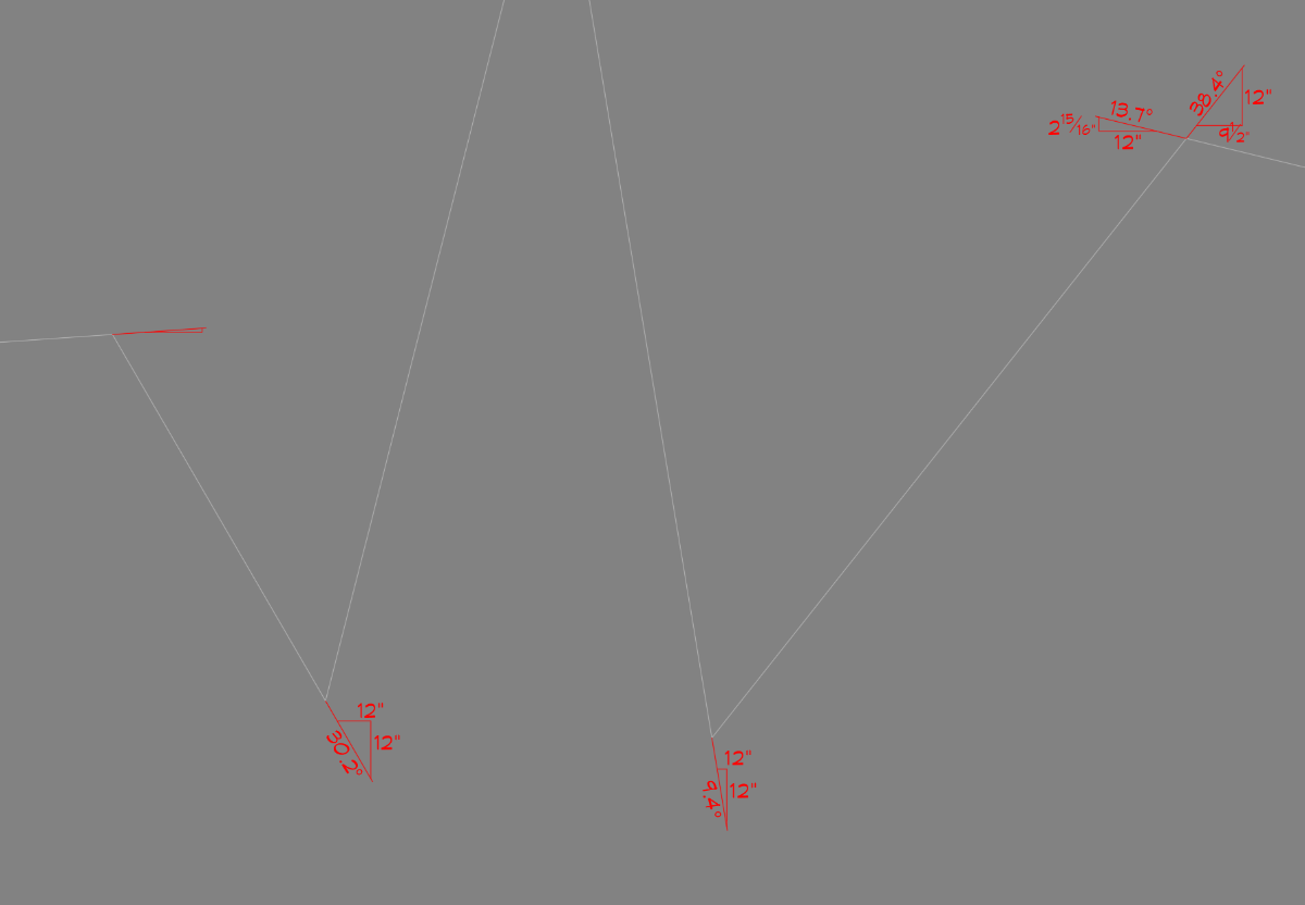

Cadkiller Posted May 29, 2025 Author Posted May 29, 2025 (edited) Okay I spoke too soon once again. One shows a 12" on 12" and the angle is 9.4% and another was blank for some reason. I gather because the angle is very low. And a couple just showed the 12" base with no angle or rise, which this one seems to be very steep. Edited May 29, 2025 by Cadkiller Quote
