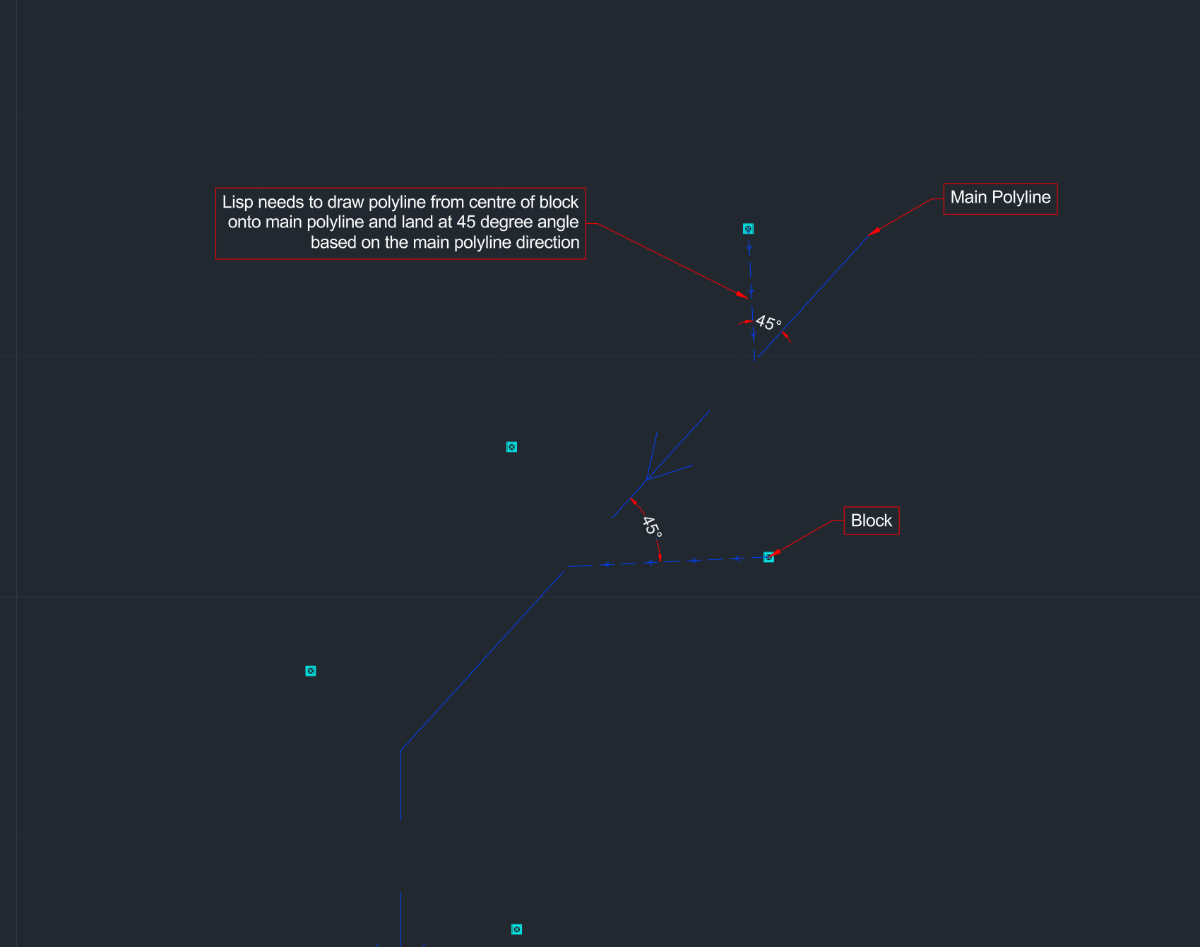

CivilTechSource Posted May 5, 2025 Posted May 5, 2025 Hi Everyone, This forum is the best as everyone is so helpful. I had this crazy idea of a lisp that you will select a number of blocks (Gullies) and a number of polylines (Pipes). Then the lisp will draw a polyline from the centre of the block (gully) towards the polyline nearest to it and land at 45 degree angle. I do not even have the slightest idea how do I tackle a problem like this. So any help or guidance is appreciated. Thank you. Quote
Emmanuel Delay Posted May 5, 2025 Posted May 5, 2025 Sure, that's not so cazy. It's just a little vague. It would be nice to see dwg example. A few things: you should draw your blocks so that the grip point is in the center. And what about those 45° (or 30° in the title) angles? Is that in any direction? Any point on the polyline has 4 directions where the block could be on ... Quote
GLAVCVS Posted May 5, 2025 Posted May 5, 2025 (edited) Hi The first thing, I suppose, is to select the block to consider and its reference point. Then you should create a set with all the polylines. From there: - Analyze each polyline in the set and obtain each of its segments to check if it is possible, from the block's reference point to any point on the segment, to create a vector that forms a 45° angle with it. - In each case where this occurs, store the vector's point of convergence on the segment + the vector's length in a list. - When the process is complete, sort the resulting list with 'vl-sort' from shortest to longest: the first element of the resulting list will contain the point from which to draw the line between the block and the correct polyline. Edited May 5, 2025 by GLAVCVS 1 Quote

CivilTechSource Posted May 21, 2025 Author Posted May 21, 2025 Thanks everyone for the response. Attached dwg. BIGAL, yes! The idea is to select gully blocks (using selectsimilar command) and then select the main pipe run and then draw lines from the gully into that pipe at the 45 degree angle. The pipe is a polyline and polyline have directions, is there a function for a lisp to read the polyline direction to identify which way the gully to connect to? GLAVCVS, thank you the pseudo code break down make the problem more digestible now! Gully to Pipe Example.dwg Quote
GLAVCVS Posted May 21, 2025 Posted May 21, 2025 I guess the necessary question in this case is: how do you identify the direction of the polyline? Does it correspond to the order of the points in the drawing's database? Quote

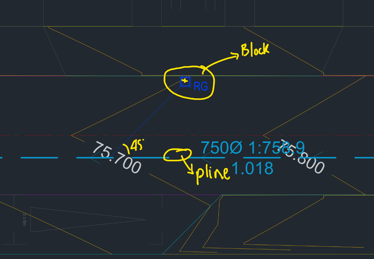

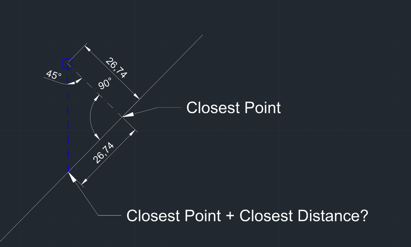

BIGAL Posted May 22, 2025 Posted May 22, 2025 Ok a few issues I joined all the plines into one else code fails. The code uses a very simple method of working out connection point, the issue is when a join is just past a vertice then angel will not be 45 so need a different approach. In this image can see the 2 answers as the 45 line meets either before or after a vertice so it would make sense at the vertice there is a PIT for change of direction of the pipe so use that point. Can you comment please. Something to play with. (defun c:gully45 ( / ) (setq obj2 (vlax-ename->vla-object (car (entsel "\nPick drain line ")))) (while (setq ent (car (entsel "\nPick block object "))) (setq obj1 (vlax-ename->vla-object ent)) (setq inspt (vlax-get obj1 'insertionpoint)) (setq objpt (vlax-curve-getclosestpointto obj2 inspt)) (setq dist (distance inspt objpt)) (setq dist2 (vlax-curve-getdistatpoint obj2 objpt)) (setq dist2 (+ dist2 dist)) (setq pt2 (vlax-curve-getpointatdist obj2 dist2)) (command "line" inspt pt2 "") ) (princ) ) (c:gully45) 1 Quote

BIGAL Posted May 22, 2025 Posted May 22, 2025 As mentioned by @GLAVCVS you can get a pline segment. so when calculate the nearest point, get the segment, if length exceeds what length is left of that segment, so go to next segment at 45 or go to vertice. Have a go come back if you get stuck. Quote

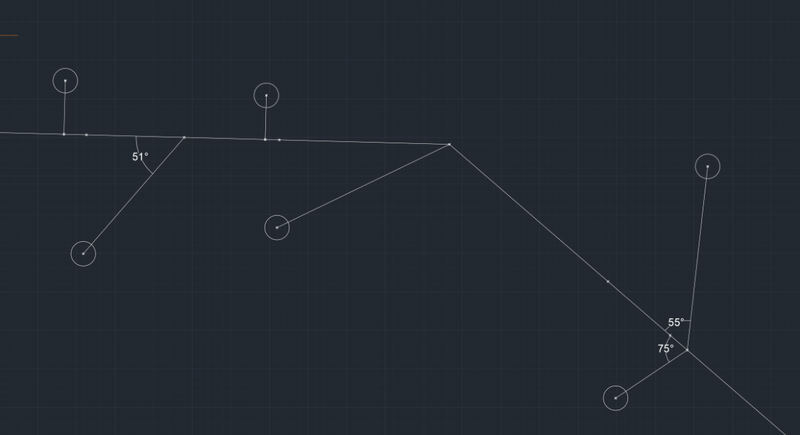

CivilTechSource Posted June 7, 2025 Author Posted June 7, 2025 @GLAVCVS Actually you did not misunderstood, automating by selecting from a list of blocks and polylines is actually quite useful! The below is what I managed to get from Gemini(AI). It works quite well to draw straight lines which is half the job, the other half is rotating. I am still writing the full code to check the angle and Join vertice as @BIGAL mentioned. (defun c:LE-Line90 ( / ssBlocks ssPolys iBlock entBlock ptBlock jPoly entPoly minDistance closestPointOnPoly currentClosestPoint currentDistance ) (vl-load-com) ; Load Visual LISP extensions for COM functions ;; --- Step 1: Prompt user to select multiple blocks --- (princ "\nSelect Blocks (press Enter when done): ") (setq ssBlocks (ssget '((0 . "INSERT")))) ; Select multiple entities of type INSERT (block) (if ssBlocks (progn (princ (strcat "\n" (itoa (sslength ssBlocks)) " block(s) selected.")) ;; --- Step 2: Prompt user to select multiple polylines --- (princ "\nSelect Polylines (press Enter when done): ") ;; Allow selection of LWPOLYLINE (2D polyline) and POLYLINE (old style 2D/3D polyline) (setq ssPolys (ssget '((0 . "*POLYLINE")))) (if ssPolys (progn (princ (strcat "\n" (itoa (sslength ssPolys)) " polyline(s) selected.")) ;; --- Step 3: Iterate through each selected block --- (setq iBlock 0) (while (< iBlock (sslength ssBlocks)) (setq entBlock (ssname ssBlocks iBlock)) ; Get entity name of the current block ;; Get insertion point (center) of the block. For a block, this is typically its origin. (setq ptBlock (cdr (assoc 10 (entget entBlock)))) (princ (strcat "\nProcessing block at: " (vl-princ-to-string ptBlock))) ;; Initialize variables for finding the closest point for the current block (setq minDistance nil) (setq closestPointOnPoly nil) ;; --- Step 4: Iterate through each selected polyline to find the closest point --- (setq jPoly 0) (while (< jPoly (sslength ssPolys)) (setq entPoly (ssname ssPolys jPoly)) ; Get entity name of the current polyline ;; Get the closest point on the current polyline to the block's center ;; vlax-curve-getClosestPointTo returns a 3D point (setq currentClosestPoint (vlax-curve-getClosestPointTo (vlax-ename->vla-object entPoly) ptBlock)) ;; Calculate the distance from the block's center to this closest point (setq currentDistance (distance ptBlock currentClosestPoint)) ;; Check if this is the closest point found so far (if (or (null minDistance) (< currentDistance minDistance)) (progn (setq minDistance currentDistance) (setq closestPointOnPoly currentClosestPoint) ) ) (setq jPoly (1+ jPoly)) ; Move to the next polyline ) ; End while (jPoly loop) ;; --- Step 5: Draw the new polyline if a closest point was found --- (if closestPointOnPoly (progn (princ (strcat "\nDrawing polyline from block to closest point: " (vl-princ-to-string closestPointOnPoly))) ;; Draw 2D polyline from block center to the closest point found on any polyline (command "._PLINE" ptBlock closestPointOnPoly "") (princ "\nPolyline drawn successfully for current block.") ) (princ "\nNo closest point found on any selected polyline for the current block.") ) (setq iBlock (1+ iBlock)) ; Move to the next block ) ; End while (iBlock loop) (princ "\nAll blocks processed.") ) (princ "\nNo polylines selected. Aborting.") ) ) (princ "\nNo blocks selected. Aborting.") ) (princ) ; Suppress the last expression's return value ) ;; Provide a command alias for easier use (princ "\nType 'DRAWCLOSESTPOLY' to run the LISP routine.") (princ) Quote
GLAVCVS Posted June 7, 2025 Posted June 7, 2025 There's something I don't understand: what happens if the polyline can't be rotated to the required angle on the selected segment? Is that never going to happen? Quote
CivilTechSource Posted June 7, 2025 Author Posted June 7, 2025 @GLAVCVS It would join the end vertex of the closest polyline segment. Quote
GLAVCVS Posted June 8, 2025 Posted June 8, 2025 So the real approach is to find the closest segment and define, at the intersection on it, the angle closest possible to those 45º 1 Quote
