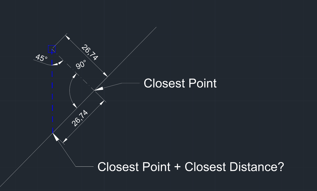

From Centre of the Block draw a polyline to another polyline and to land at 30 degree.
@GLAVCVS When you phrase it like that it makes total sense! So I presume these will be the steps:
1) Add all blocks to a list (SelectedBlockList)
2) Add all polylines to a list (SelectedPolylineList)
3) Take one block at a time and find the closest polyline segment to it. Will the be a while loop?
4) Once found the nearest polyline, we can use GetClosestPoint to find the closest point
5) Since its a 45 degree angle we are looking at, the 45 degree point along the closest polyline would be equally to ClosestPoint + ClosestDistance. (See image below). So How do i write in lisp closest point on a polyline + a distance?
*Fool Proofing Idea: Would it be best to make sure the lisp can accept an angle from the user? So it can work on any given angle?

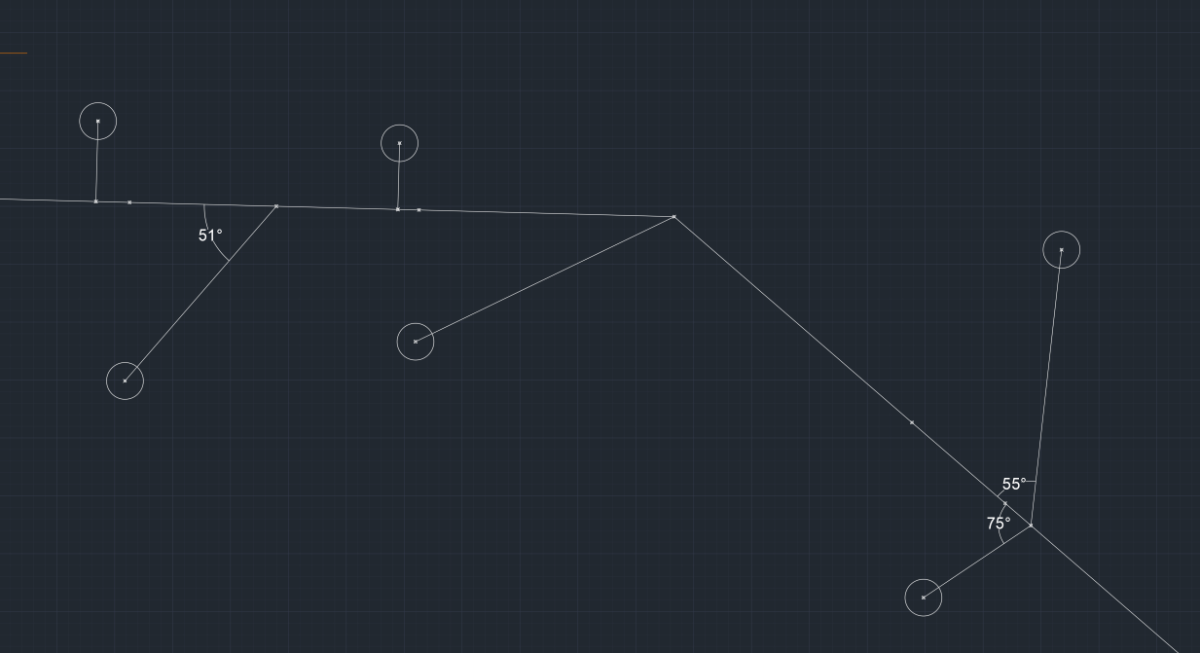

My To do list is getting bigger, as I said before there are 3 choices a 45 line, a got to vertice or got to next segment. Will try to find some time look at image May 22, shows 2 possible solutions.
  • 2 weeks later...
@BIGAL The code you wrote make absolute sense in theory. However, for whatever reason autocad decides randomly to either draw a perpendicular line or a line with a steeper angle. Before its starts doing the calculations I made sure I cleared all the values. But still sometimes it draws lines that should not be. When I debug it it seems to work fine, when I load it and run it without monitoring seems to not follow the structure. Is the vlax-curve-getpointatdist or vlax-curve-getclosestpointo?

Can you post dwg it may be that the end point is on the next section of the pline and not working that out correct.
Yes need to go back to it and do some texting and add match to vertex.
