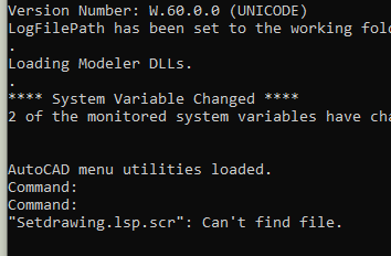

i was hoping to create a script with all 850+ dwgs like this:-
open dwg1 copybase 0,0,0 all  close n new paste 0,0,0 save dwg1
but as soon as the file is closed, or the new one is opened the script stops.  is it possible to have a a lisp in the new template that runs a paste command on start up? all i then need to figure out is how to pass the save time to teh new instance....

Ive tried doing the above with a script but it trips over when opening new file, so having to do manually one by one at mo.
