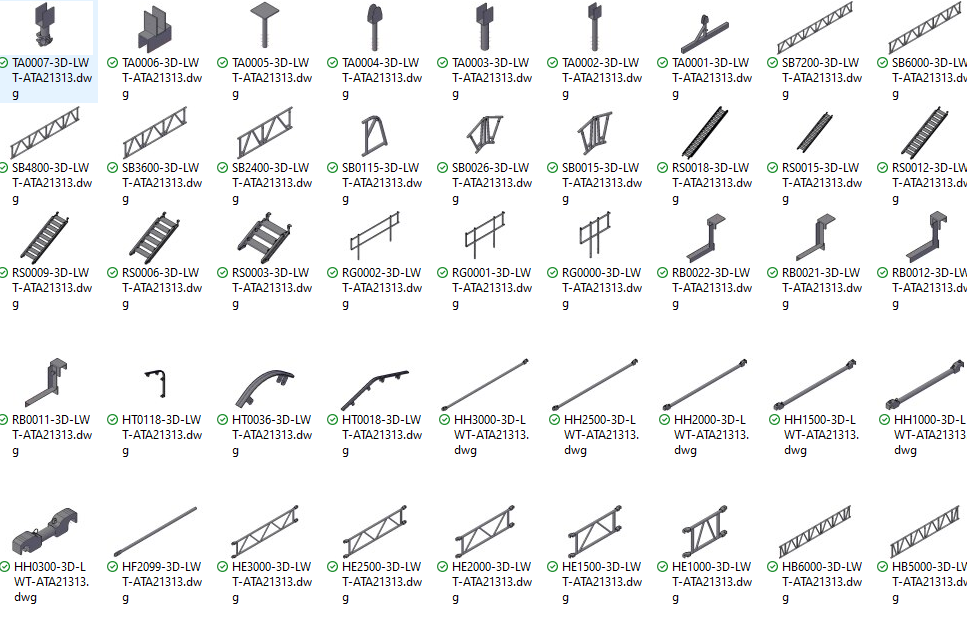

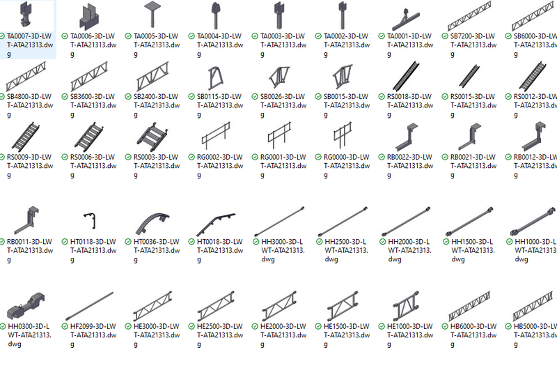

i also noticed that all the dwg icons were inverted when i scripted out all the wblocks !

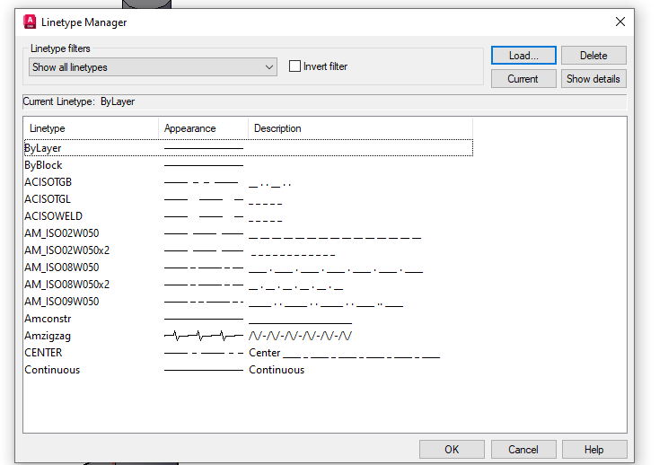

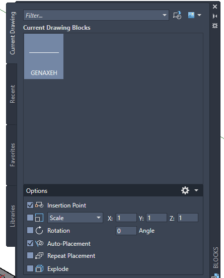

No, it has many linestyles in it that are not needed or puregable, also a block GENAXAH that is not purgeable.
I have now script wblocked out the entities and saved a mirror copy, this creates a clean drawing but doesn't solve the issue of extra layers, items on wrong layers, default colors, linetypes , transpancey etc etc etc
image.png.ed89983536ae9bd5374154386eba2e8d.pngimage.png.ab46e223b58fbb7690d82ad543c3d6f1.png

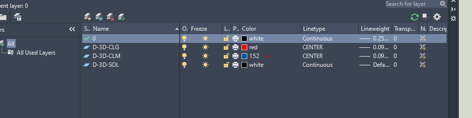

the layer color isnt correct either as i have now set layer D-3D-CLM to blue (color 5)

Have you thought about what if it exists as part of this call "(ensure-layer "D-3D-CLM" 5)", your doing a does not exist but you can do a set color if exists. Look at your "ensure-layer".
Example code to put in your defun, same if want to change linetype.
(command "-layer" "C" color name "")

Thanks for suggestion
I had done exactly as suggested but I did it as a script file rather than lisp routine
adding lines for linetyp, line weight and transparency .

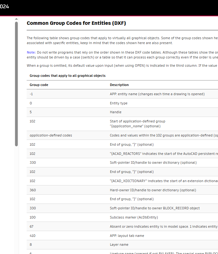

in the ensure-layer function below the layer name is referenced as dxf group code 2
(defun ensure-layer (name color)
  (if (not (tblsearch "LAYER" name))
    (entmake
      (list
        '(0 . "LAYER")
        '(100 . "AcDbSymbolTableRecord")
        '(100 . "AcDbLayerTableRecord")
        (cons 2 name)         ; Layer name
        (cons 70 0)           ; Layer flags
        (cons 62 color)       ; ACI color
        (cons 6 "Continuous") ; Linetype

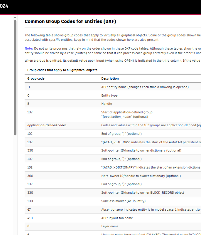

the autocad reference provides 8 as the layer as shown on the attached image.
is this because we are assigning a name under entmake rather than reading a name
The DXF data list supplied to entmake in your ensure-layer function is creating a layer table record (or LAYER entity), for which the reference may be found here, whereas DXF group 8 typically contains the layer referenced by another entity.

Only one way to clean those Mechanical files.
;;; AutoCAD Mechanical .dwg and export to AutoCAD .dwg to remove Mechanical Layers and Linetypes, etc.

My apologies for not realizing those AM files needed to -EXPORTTOAUTOCAD to completely clean them. I already do Map 3D, Civil 3D, etc. with that routine as well as my own Mechanical files. I could have took care of those right away.

this works a treat, many thanks. It gets rid of all the acadm linetypes,blocks and dims
as a work around i have wblocked out items and this has the same effect of getting rid of the not used items, i am more comfortable with using your routine going forward as I am still unsure what template wblocked entities use.

We have blocks created in vanilla cad, acadm, fusion and inventor.
From these extracted blocks I create 'lightweight' blocks with wall thicknesses, fillets radii removed etc. this is a manual process and takes quite some.
this whole exercise is to regularise these blocks for use i building assemblies and for distribution. going forward i will have much stricter rules for preparation of the lightweight blocks to avoid this mess in the future.

below outlines my manual procedure to dwgclean
-bind any xrefs
-explode any blocks
-create layers D-3D-SOL, D-3D-CLG, D-3D-CLM
-move all solids or surfaces to layer D-3D-SOL
-move all lines, plines and circles with color less or equal to 100 to layer D-3D-CLG
-move all lines, plines and circles with color greater than 100 to layer D-3D-CLM
-set all entities color bylayer, linetype by layer , transparency bylayer
-delete all entities from layer 0
-set layer 0 color 7(black), lineweight default, transparency 0 (default?)
-set layer D-3D-SOL color 7(black), lineweight 0.3, transparency 0 (default?)
-set layer D-3D-CLG color 1(red), lineweight 0.18, transparency 0 (default?)
-set layer D-3D-CLM color 5(blue), lineweight 0.18, transparency 0 (default?)
-set layer 0 as current
-purge unused items (3 passes)
-set ucs to world
-set viewstyle to conceptual
-set view to _swiso
-zoom extents
-create subfolder in the current drawing folder 'cleaned'
-exporttoacad sending cleaned drawings to the 'cleaned' folder using same dwg name
