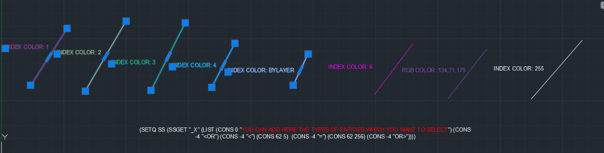

I have run a couple of tests and there is an issue with the colours.
all lines/pline/circles are being placed on layer D-3D-CLM. Layer D-3D-CLG is then being purged
i need entitles with a colour less than 5, or whos colour is BYLAYER and residing on a layer of a colour < 5 to be moved to D-3D-CLG.
The remaining lines/pline/circles are moved to D-3D-CLM
i think the issue is that the code is looking a colour <5 which it will be if set bylayer?
i have checked the code below and it seems to be flagging entities either coloured or bylayer  (although it is picking up way more entities tan actually in the drawing?)
Could  a return value from this  be used in the dwg processor to ensure line/pline and circles are filtered correctly?
You can use something like this from the image below (when I run it, it only selects entities with color < 5 and entities with color BYLAYER), this replaces your code from above. After that, you can iterate through the selection set and do what you want to achieve.

FWIW, I found this which looks promising for transparency in the future... Get and set layer and entity transparency using LISP - AutoCAD DevBlog
For your last issue, you're calling CheckEntColor function before it's been defined.
LISP processes code sequentially, so if a function isn't defined yet, you can't call it.
Maybe like this... (I didn't test it and didn't add comments where Saxlle provided the answers)

(not (CheckEntColor ent))
To
(not (CheckEntColor (vlax-vla-object->ename ent)))
Also you need _.-VISUALSTYLES

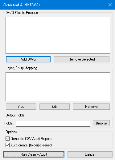

I have in the works a DCL edition, should include options to run things individually as well as a dropdown to add the drawings, to be run. It's just going to take me some time, this was a start, but I am also redesigning it.
This looks awesome .
