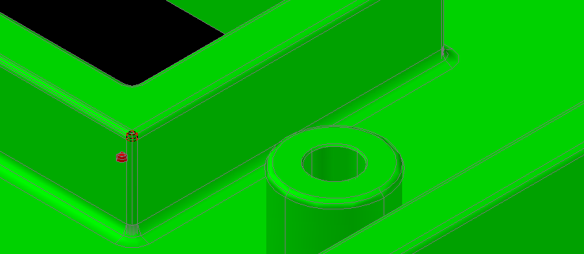

Berzerker Posted Saturday at 01:09 PM Posted Saturday at 01:09 PM Ok at 2D but I consider myself a rookie even though I've played around with AutoCad since the 90's. I try to dabble in 3D every now and then to learn. I wanted to bevel the edges of a cover for 3D printing and when the last piece of the shape I want to subtract from the object is placed and I hit enter, the whole thing disappears. I go back making sure to pay attention as to what I want subtracted from what. All the other pieces subtracted just fine ... it's just the last piece. Quote

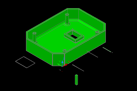

Berzerker Posted Saturday at 02:36 PM Author Posted Saturday at 02:36 PM I use the fillet command. it's all I know how to use. In the left lower corner, you can see where I made the shape to subtract from the cover. I've tried to union them together and then subtract and I've tried it as separate pieces. In the first picture the shape I want subtracted is sitting off the part to show it is a separate object and isn't in place. When I place it in place and hit enter cover and all that was selected disappears. Quote

Berzerker Posted Saturday at 02:47 PM Author Posted Saturday at 02:47 PM (edited) Select object to subtract from: I select the cover Select objects to subtract: I select the shape I hit enter: everything disappears, cover and all Edited Saturday at 02:58 PM by Berzerker Quote

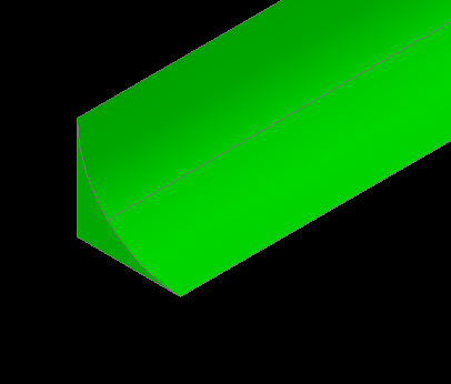

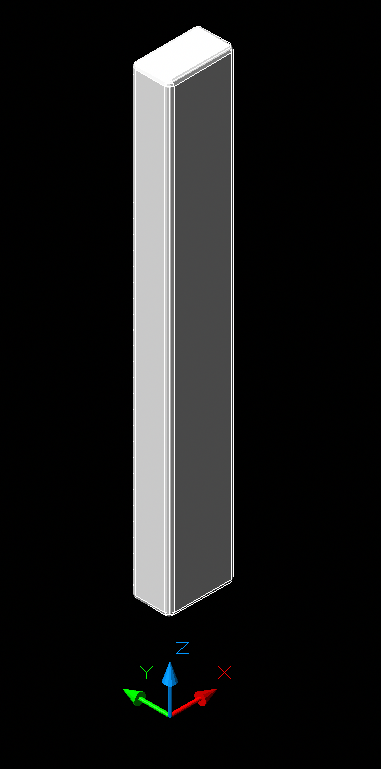

Berzerker Posted Saturday at 06:38 PM Author Posted Saturday at 06:38 PM (edited) Fillet But maybe I'm missing something here? I made a shape of a rounded fillet and want to subtract the shape from the square corner of the cover to make it rounded. shape to be subtracted looks like this. Edited Saturday at 06:47 PM by Berzerker Quote

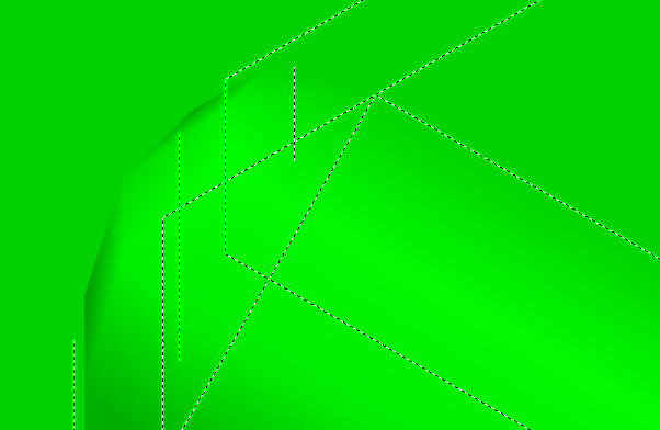

Berzerker Posted Saturday at 07:07 PM Author Posted Saturday at 07:07 PM Here is the corner shape copied and put where I want to subtract. It's just the last corner. As you see all the other edges are rounded ... no problem. I only like about five corners left and I can print. Quote

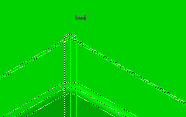

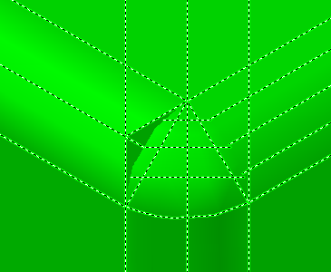

Berzerker Posted Saturday at 07:21 PM Author Posted Saturday at 07:21 PM (edited) I think I found my problem. Undoubtedly, I was off just a few ten thousand and somehow, it's now confused. Pay attention to thethree-line fillet and the five line fillet. Edited Saturday at 07:25 PM by Berzerker Quote
ReMark Posted Saturday at 07:38 PM Posted Saturday at 07:38 PM You should have been able to FILLET the edge without creating any shapes. Quote

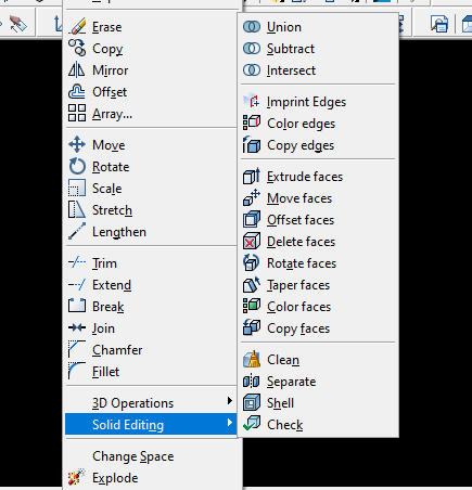

Berzerker Posted Saturday at 10:51 PM Author Posted Saturday at 10:51 PM 2007 doesn't have a filletedge command , only chamfer and fillet. Quote
ReMark Posted yesterday at 10:17 AM Posted yesterday at 10:17 AM 11 hours ago, Berzerker said: 2007 doesn't have a filletedge command , only chamfer and fillet. And that's why God created the Internet and search engines. "In AutoCAD 2007, the Fillet command can be used in 3D to create rounded edges on 3D solids. To use it, you need to select the "Fillet Edge" option from the Solid Editing panel. You will then select the edges of the solid you want to fillet and specify the radius. Ensure that the objects you are filleting are at the same elevation." Quote
SLW210 Posted 23 hours ago Posted 23 hours ago If you would just post the drawing, you could be directed how to do it. Fillet works on 3D just fine. This is AutoCAD 2000i. Command: f FILLET Current settings: Mode = TRIM, Radius = 0.5000 Select first object or [Polyline/Radius/Trim]: Enter fillet radius <0.5000>: Select an edge or [Chain/Radius]: Select an edge or [Chain/Radius]: Select an edge or [Chain/Radius]: Select an edge or [Chain/Radius]: Select an edge or [Chain/Radius]: Select an edge or [Chain/Radius]: Select an edge or [Chain/Radius]: Select an edge or [Chain/Radius]: Select an edge or [Chain/Radius]: Select an edge or [Chain/Radius]: Select an edge or [Chain/Radius]: Select an edge or [Chain/Radius]: c Select an edge chain or [Edge/Radius]: 12 edge(s) selected for fillet. Quote
