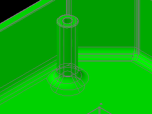

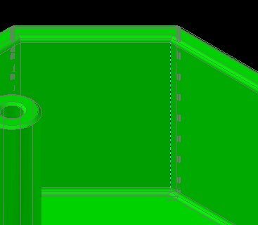

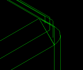

Berzerker Posted yesterday at 12:13 PM Author Posted yesterday at 12:13 PM (edited) Take a look at the lines on the corner. That doesn't look right to me. Here's the drawing Mindblower 5.0 speaker bottom cover fix.dwg Edited yesterday at 12:14 PM by Berzerker Quote
ReMark Posted yesterday at 02:42 PM Posted yesterday at 02:42 PM (edited) "How to Use the #D Fillet Command in AutoCAD 2007" as posted on YouTube. Here is the link. Note: Way up at the top left-hand corner it says AutoCAD 2007 - (Drawing1.dwg). Edited yesterday at 02:44 PM by ReMark Quote
Berzerker Posted yesterday at 03:27 PM Author Posted yesterday at 03:27 PM Something has happened to the solid cover. It's corrupt or something. I tried that yesterday and it didn't work. So, I tried it on another solid in the drawing and it worked. Now that I know a different way I can easily make it over and will take a tenth of the time. Thanks ReMark and SLW210 I wish someone had told me this years ago. Quote
Berzerker Posted yesterday at 03:34 PM Author Posted yesterday at 03:34 PM (edited) One more, Am I to assume that if fillet rounds edges in 3D that chamfer will do the same at the base of built in spacers? Where I don't have to create a shape, revolve it and then place it and union it? pictured here: Edited yesterday at 03:35 PM by Berzerker Quote
ReMark Posted 22 hours ago Posted 22 hours ago (edited) Chamfer will put a beveled edge on an object. There will be no voids to fill in or worry about. Edited 22 hours ago by ReMark Quote
SLW210 Posted 19 hours ago Posted 19 hours ago Yes, you can chamfer as well. Yes, you have issues with the solid in the drawing you posted. Most likely from trying the subtract and union. You are correct, you should be able to start over and do a better job. If you hit a snag just ask questions and post the .dwg if you need the solid looked over. Quote
