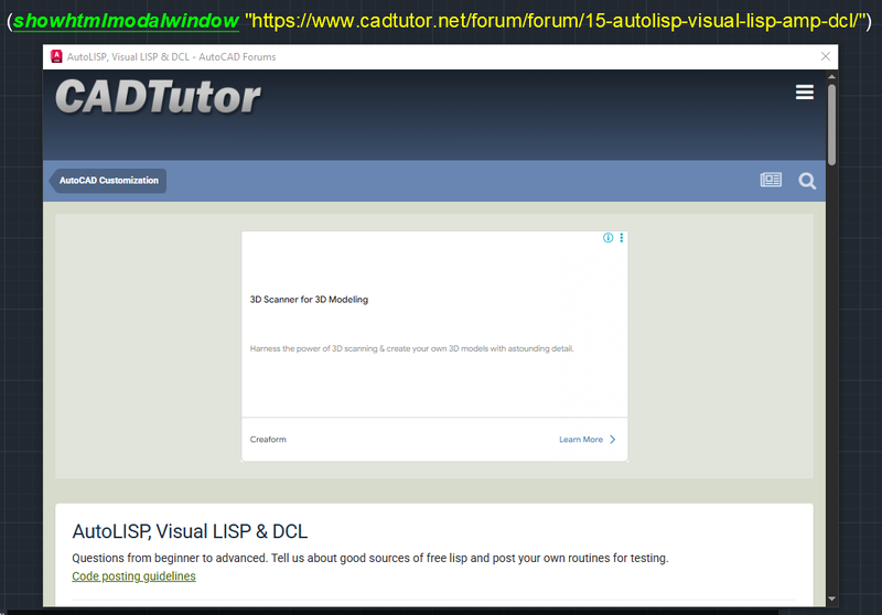

Saxlle Posted July 3, 2025 Posted July 3, 2025 Also, if you are using AutoCAD 2024LT or AutoCAD 2024, there is built-in function as I mentioned, and you can use it, and you will get something like this (picture 1). Picture 1. showhtmlmodalwindow Quote
BlackBox Posted July 3, 2025 Posted July 3, 2025 On 6/28/2025 at 3:32 AM, Saxlle said: You can also try with showhtmlmodalwindow. Wish this were modeless instead of modal, so you could switch between them. Browser command, and startapp + explorer + url work fine. Webload command is really neat, but most don't do Javascript/HTML. 1 Quote
Saxlle Posted July 3, 2025 Posted July 3, 2025 6 minutes ago, BlackBox said: Wish this were modeless instead of modal, so you could switch between them. Agree with this, it would be great. Quote
