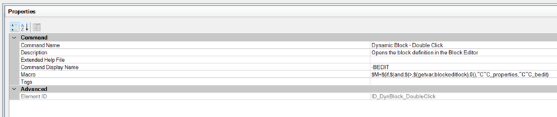

ColinPearson Posted July 14, 2025 Posted July 14, 2025 Hello internet world. I feel like something changed in my CAD a couple months ago and I can't double click a block to open the Block Editor anymore. I started getting this message "The selected block has no editable attributes." I've been getting by by using either REFEDIT or BEDIT but it's annoying not being able double click. For both Blocks and Dynamic Blocks, the double click action in the CUI is set to BEDIT. This affects all blocks in all drawings. I've attached a sample drawing if it helps. Any ideas? Thank y'all in advance!! Drawing1.dwg Quote

ColinPearson Posted July 15, 2025 Author Posted July 15, 2025 Thanks for the reply @Steven P. I had all those the same except QAFLAGS which was set to 16. Never heard of that one; I set to 0 but saw no change. I also have checked that nothing got wonky in the CUI, and for the Double Click Action for both Blocks and Dynamic Blocks, I have the same command. I have seen versions of advice that say it should read BEDIT, -BEDIT, and _BEDIT and have tried all of them with no effect. Also ran SYSVARMONITOR and changed PICKAUTO and SELECTIONPREVIEW to their preferred values, still no change. However, I expanded my command lines at the bottom and took a better look at what's happening. When I double click on a Block, I get the following, so it's actually trying to run TEXTEDIT, despite the fact that I have BEDIT set in the Double Click Action. Command: ampoweredit textedit Current settings: Edit mode = Multiple Select an annotation object or [Undo/Mode]: The selected block has no editable attributes. Select an annotation object or [Undo/Mode]: nil Quote
SLW210 Posted July 16, 2025 Posted July 16, 2025 Which AutoCAD Mechanical version are you using? Does this happen in Vanilla AutoCAD? My Double-Click Dynamic Block has the same thing and works fine. Both AutoCAD 2026 and AutoCAD Mechanical 2026. Attribute blocks and attribute dynamic blocks have ^C^C_eattedit. My command line... Command: ampoweredit Command: Command: Command: Command: _bedit Regenerating model. Regenerating model. Sounds like you need to reset to defaults, if that doesn't work a repair or report issue to Autodesk. 1 Quote
ColinPearson Posted July 16, 2025 Author Posted July 16, 2025 @SLW210 I'm on 2023. My Attribute Blocks and Attribute Dynamic Blocks have the same as you I'm pretty sure. I just switched to Vanilla and it acts the same. If I restore defaults, I forget how offhand, but I know I can reload my CUI to get the workspace/toolbars/keyboard shortcuts/etc all back, but I wonder if that would bring the same problem back? Thank you! Quote
SLW210 Posted July 16, 2025 Posted July 16, 2025 It seems you have something redefining this action. I would reset to defaults and run like that to see if the problem is still there, then slowly redo my settings, though it's strange it happens in both. Did you actually try AutoCAD or just switched profiles? Try a new instance of actual AutoCAD if you can. Windows updates? Which OS are you using? Quote
ColinPearson Posted July 16, 2025 Author Posted July 16, 2025 @SLW210 WHOAAAAAAAAAAAAAAAAAAAA THERE, I think you're onto something. I had previously just switched to the VANILLA profile b/c I thought that's what you meant. After your follow up, I opened some dwgs in the non-Mech version and the double click on the blocks now behaves as expected. One weird thing is that in plain ACAD, when I double click on dimensions, I get the Power Dimensioning dialog popping up which I fought for a while ... I can't recall what I did before to just have the dimension text open in a Text Editor instead of the Power Dim. Quote
