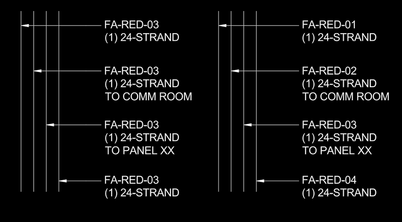

rsdonna Posted July 25, 2025 Posted July 25, 2025 I'm looking for a lisp that will allow me to do the exact same thing I do with TCOUNT but for multileaders. I have a drawing where I have mleaders going to many different lines and each has three lines of text. The first line has cable id and I want to be able to replace the last two characters of that line. In TCOUNT I would select each mtext object in order, have the count start at 1 and increase by 1 (1,1) and then I would have it find and replace the '0' I left at the end of each line with the sequential numbers created by TCOUNT. This is what I need to be able to do but on all the mleaders I have in this drawing. Anyone have something like this? Quote

rsdonna Posted July 26, 2025 Author Posted July 26, 2025 Sure, here is a sample of what I'll have in my drawings. In my drawings I'll have maybe 50 mleaders like these and I'm looking for a way to be able to pick them in order and then have it replace the -00 at the end with the sequential numbering. In TCOUNT I can pick what number I want it to start from and what the increment will be and then whether I want to overwrite, find and replace (which is what I need it to do), and also a prefix and a suffix option to place the text. Thanks for your help SAMPLE.dwg Quote
BIGAL Posted July 26, 2025 Posted July 26, 2025 (edited) Give this a try, also it replaces what ever is the last 2 characters. Call it version 1. ; https://www.cadtutor.net/forum/topic/98622-tcount-for-multileaders/ ; change mleader text add number on end. ; By alanH jultu 2025 (defun c:wow1 ( / num str newstr obj len) (setq num (getint "\nEnter start number ")) (while (setq ent (entsel "\nPick Mleader - Enter to stop. ")) (setq obj (vlax-ename->vla-object (car ent))) (setq str (vlax-get obj 'textstring)) (setq len (strlen str)) (if (< num 10) (setq newstr (strcat (substr str 1 (- len 2)) "0" (rtos num 2 0))) (setq newstr (strcat (substr str 1 (- len 2)) (rtos num 2 0))) ) (vlax-put obj 'textstring newstr) (setq num (1+ num)) ) (princ) ) Edited July 27, 2025 by BIGAL Quote
rsdonna Posted July 27, 2025 Author Posted July 27, 2025 13 hours ago, BIGAL said: Give this a try, also it replaces what ever is the last 2 characters. Call it version 1. ; https://www.cadtutor.net/forum/topic/98622-tcount-for-multileaders/ ; change mleader text add number on end. ; By alanH jultu 2025 (defun c:wow1 ( / num str newstr obj len) (setq num (getint "\nEnter start number ")) (while (setq ent (entsel "\nPick Mleader - Enter to stop. ")) (setq obj (vlax-ename->vla-object (car ent))) (setq str (vlax-get obj 'textstring)) (setq len (strlen str)) (if (< num 10) (setq newstr (strcat (substr str 1 (- len 2)) "0" (rtos num 2 0))) (setq newstr (strcat (substr str 1 (- len 2)) (rtos num 2 0))) ) (vlax-put obj 'textstring newstr) (setq num (1+ num)) ) (princ) ) This is great. Is there a way to have it still do this if there are multiple lines of text in the mleader? I still have the wire name at the top line always but sometimes add 1 or 2 additional lines with other info about that wire. Thanks for your help. SAMPLE.dwg Quote

BIGAL Posted July 27, 2025 Posted July 27, 2025 (edited) I guess look for newline then work backwards two characters. Try this. (defun c:wow ( / num str str1 str2 newstr obj len ) (setq num (getint "\nEnetr start number ")) (while (setq ent (entsel "\nPick Mleader - Enter to stop. ")) (setq obj (vlax-ename->vla-object (car ent))) (setq str (vlax-get obj 'textstring)) (setq pos (vl-string-position 92 str)) (if (= pos nil) (progn (setq len (strlen str)) (if (< num 10) (setq newstr (strcat (substr str 1 (- len 2)) "0" (rtos num 2 0))) (setq newstr (strcat (substr str 1 (- len 2)) (rtos num 2 0))) ) ) (progn (if (< num 10) (setq newstr (strcat "0" (rtos num 2 0))) (setq newstr (rtos num 2 0)) ) (setq str1 (strcat (substr str 1 (- pos 2)) newstr)) (setq str2 (substr str (+ pos 1))) (setq newstr (strcat str1 str2)) ) ) (vlax-put obj 'textstring newstr) (setq num (1+ num)) ) (princ) ) Edited July 28, 2025 by BIGAL Quote

rsdonna Posted July 28, 2025 Author Posted July 28, 2025 1 hour ago, SLW210 said: I linked several LISPs in that thread, which ones did you try? I tried CopyText and MTMTMLT. I found CopyText great as it is something that I will end up using quite a bit since I have to copy text to multiple mleaders sometimes, but neither of the ones I tried did what I was looking for unfortunately. MTMTMLT only adds the sequential numbering at the end and doesn't let me replace what I have in the text as a place holder. What I need replaced is always at the end of the first line and since I have multiple lines of text sometimes it doesn't work with the numbering being added at the end of all the text Quote
SLW210 Posted July 28, 2025 Posted July 28, 2025 There was a link to a LISP at Autodesk forums as well. I have a few versions of my LISP as mentioned in that thread, I'll think about updating and altering one if I get time. I need a clearly explained before and after .dwg, just go through what you do in TCOUNT, better yet show it with TCOUNT on MText as well, even with your drawings as MText, I followed the steps you gave in your first post and do not get the results you ask for. Quote
