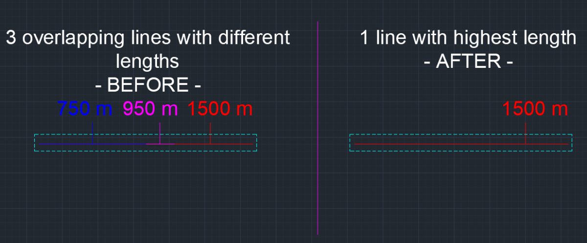

Hi @p7q,
If this what you want, you can try with this:
(prompt "\nTo run a LISP type: DOL (DeleteOverlappingLines)")
(defun c:DOL ( / ss len i ename_length_list ename ename_length)
  (setq ss (ssget (list (cons 0 "*LINE")))
        len (sslength ss)
	i 0
	ename_length_list (list)
  (while (< i len)
    (setq ename (ssname ss i)
	  ename_length (getpropertyvalue ename "Length")
	  ename_length_list (append ename_length_list (list (list ename ename_length)))
	  i (1+ i)
  (setq ename_length_list (vl-sort ename_length_list (function (lambda (x1 x2) (< (cadr x1) (cadr x2)))))
	ename_length_list (vl-remove (last ename_length_list) ename_length_list)
	total_len (itoa (length ename_length_list))
  (foreach x ename_length_list
    (entdel (car x))
  (prompt (strcat "\nThe total number of deleted lines is " total_len "!"))
and you will get something like this (picture 1).
Note: you need to select group by group to get only line or polyline with the highest length.
Best regards.
