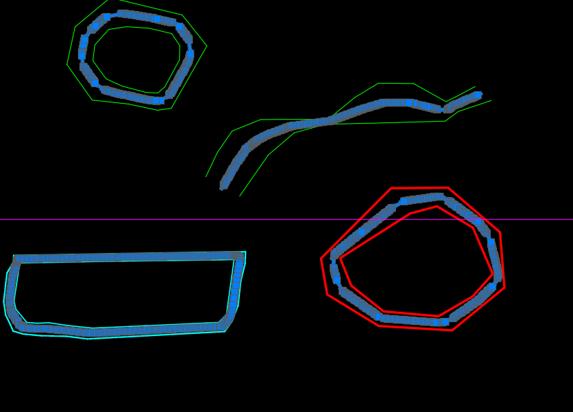

In my case, I set the "length of arcs" to 1. And it worked. But I think the resulting axis isn't very geometrically rigorous. I've attached an example image:
-The polyline created by the command is shown in green.
-The correct geometry of the axis is shown in dashed red.
I think there should be a more geometrically rigorous solution in some older Lisp.
Is it possible?
Does anyone know of one?

Thanks again for your code, @mhupp
It seems that the differences in the turning zones between the resulting geometry and the expected geometry persist.
I must say that the goal is to obtain an axis that remains equidistant from the reference polylines at all times.
I thought this problem would easily find a solution here.
Maybe I was wrong
Edited by PGia

Here's a simpe solution that doesn't use LISP.
Change the elevation of one of the polylines to 1.0 then use the loft command to create asurface.  Section the resulting surface with an XY plane at 0,0,0.5.
  • Like 2
  • Agree 3
Thanks, @lrm
It seems your method relies on there being pairs of points close together between both polylines.
But when several points accumulate on one of them and don't find a corresponding point on the other, the calculated axis deviates from the center, and the method loses consistency.
To keep these cases under control, I think it is best to manage them using a Lisp.
But maybe I'm wrong 😅

That said, I just tried Lee Mac's cPoly in mhupp's last link posted, seems to be similar results to mine if you adjust the sample points.
I haven't checked the others yet, I'll run through them if I get time.
I originally made mine with the command function, then changed it to entmake, pretty sure the accuracy is the same, it just had a lot of
"Specify next point or [Arc/Close/Halfwidth/Length/Undo/Width]:"  in the commandline for each sample.
P.S. Mine should take into account reversed polylines.
At the same sample size, mine and Lee Mac's seem to be exactly the same on your drawing.
