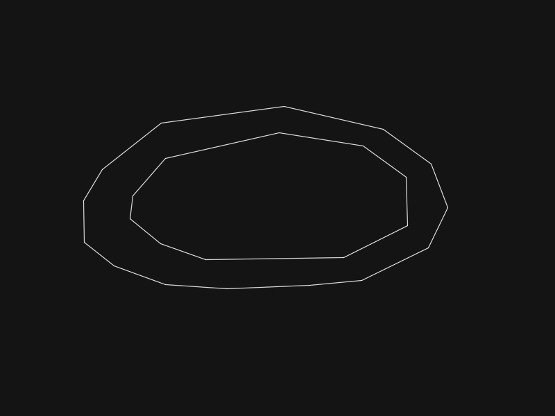

I think the real-world situation may be more complex than what we’ve seen here so far.
I took a look at the links that @SLW210 attached and decided to test the Lisp codes proposed up to this point.
I looked through my drawings for something that could serve as an example for this problem, but it was like looking for a needle in a haystack.
So, in the end, I decided to look for something in the real world that clearly corresponds to this issue — something like this:
So I drew those margins and tested all the codes that have appeared in this thread so far.
The result was… this!
In the drawing, you can see the ones that managed to reach the end.
However, the codes by BIGAL, GP_, GLAVCVS, and MarkoRibar couldn't even do that.
Here’s the drawing
AxisExple4.dwg
Edited by PGia
  • Like 3
Hi @PGia, wow, you managed to find another example that fails. Good stress testing!
The reason mine fails is because it ignores the offset lines that are split in two or more parts.
But some of the parts are still be usable and should be used.
I looked into fixing this and managed to add those lines, but this resulted in some other problems so I didn't update the code on the earlier post yet.
The zigzag problem is coming back on your example. The result below.

@dexus, the performance of your code looks different in that last drawing compared to what I’m seeing on my end.
In any case, I think this topic has now entered the realm of a real challenge.
@BIGAL: I agree. I think that’s the correct way to draw the centerline in the inlets.
Obviously, this has now become something more than just the search for a solution to a single user’s problem.
First of all, I should say that I myself was also reluctant to accept the concept of equidistance advocated by @GP_ and @dexus
For the simple reason that applying this principle forced me to accept that the centerline should be the same in these two drawings.
Equidistance requires ignoring those areas of the margins that do not geometrically affect the axis.
This, which initially caused me some resistance, I eventually came to accept conceptually when I realized that it could serve as a criterion for defining what is a “recodo/inlet” and what is not.
So I have abandoned my previous approach and adapted it to this new situation.
Having made this clarification, I must say that this concept of equidistance makes the calculation of a centerline more feasible.
I’ve been running some tests with Dexus’s latest code, which is the best so far.
However, I’ve discovered some “holes” that I hadn’t noticed before.
I’m attaching a few images showing this.
In my view, these are conceptual errors rather than geometric limitations.
And what can we consider “geometric limitations”?
I believe that, in any case, every vertex of the centerline must be equidistant from both margins.
If this is not the case, the result is not correct.
However, the intermediate regions along each segment may be subject to geometric limitations depending on the desired precision.
Therefore, in bends or turns, the points taken within the adjustment or “problematic” segments may deviate (within a tolerance) from strict equidistance.
The goal, therefore (in my opinion), should be to achieve equidistance at every vertex and to remain within a tolerance in the intermediate zone of each segment.

Attempt number 2:
This code is intended to always return a centerline whose points are all perfectly equidistant from the margins.
This should happen in all cases where two LWPOLYLINEs are provided, one for each margin.
The case of islands has not been considered yet.
The resulting centerline is geometrically dense. This can probably be simplified in a future version.
The approach taken in this code has been to obtain points from the normals and the bisectors of each margin, which are then combined at the end to build a list of points.
Therefore, it is a fragmentary and massive approach. For this reason, the code is not very fast.
However, there is another, more elegant approach, based on dynamically relating the geometry of both margins.
It is more complex, but it would also be faster, and the error margins would be “bridgable”.
If this thread has enough life in it, I may feel sufficiently motivated to finish it.
That’s all for now.

I tested the code.
All the points are equidistant, but there are two long segments where the equidistance is drastically broken.
In the last screenshot Dexus attached, you can see approximately where the center line should be in that area.
The center line returned by the GLAVCVS code is shown in magenta.
And the approximate location where it should be is shown in red.
I've attached an image of this
  • Agree 1
10 hours ago, PGia said:
I tested the code.
Yes. I know.
I already mentioned that this problem could arise on some long segments during turns.
I didn't want to delay posting again to fix this.
But I already have an idea of how to solve it.
I'll post the solution as soon as I can.

After being too busy working on my 2025 financial balance, I’ve had a bit of time to test the latest published codes.
In addition, I found a new “toy” to test them with.
To see the result in detail, you can download the attached drawing.
Another.dwg
In the images I show some examples of what I have observed:
There are still some significant errors in the equidistance of the centerline. The latest code by glavcvs seems to always achieve equidistance at all points. However, inside some segments there are errors of more than 1 meter. I assume this is an issue that glavcvs has already solved but apparently has not yet published.
The code by dexus has similar problems, but in addition there are also some points with significant errors in equidistance.
Finally, I have also noticed that the latest code by glavcvs does not work on some of the drawings attached as examples in this thread.
I suppose we are going very far—
further than what was initially intended.
For most people who come across this, this will probably be sufficient.
But “immortality is always a little further ahead.”
Many thanks to everyone who has participated in this so far 🙂
and to those who will do so in the future! 😊
There is something that might be interesting:  what is the best equidistant centerline that can be obtained with other programs?
If anyone has a specialized tool for this, it would be very interesting if they could attach a DXF with the result for the drawing in my previous post.
