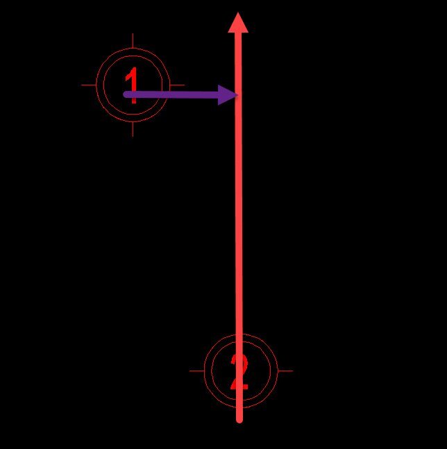

@SLW210Thank you for looking! If I choose axis 2 as the reference, then axis 2 does not move and axis 1 moves and aligns with axis 2.

This is a LISP program that displays text and blocks vertically. I've modified it according to your instructions, and it works, but not exactly as I expected.
My goal is that when I select an object to align, other objects will align with the selected object (the object selected for alignment will not move).
Thank you very much for your help.
