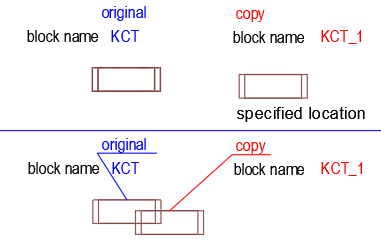

Nikon Posted Tuesday at 02:39 PM Posted Tuesday at 02:39 PM Hi, everybody. In this code, a copy of the block is superimposed on the original, how to change the code to insert a copy of the block at the specified point. ;;-----------------=={ Copy/Rename Block Reference }==------------------;; ;;----------------------------------------------------------------------;; ;; Author: Lee Mac, Copyright 2013 - www.lee-mac.com ;; ;;----------------------------------------------------------------------;; ;; Version 1.5 - 05-07-2013 ;; ;;----------------------------------------------------------------------;; (defun c:cb nil (LM:RenameBlockReference t)) (defun c:rb nil (LM:RenameBlockReference nil)) (defun LM:RenameBlockReference ( cpy / *error* abc app dbc dbx def doc dxf new old prp src tmp vrs ) (defun *error* ( msg ) (if (and (= 'vla-object (type dbx)) (not (vlax-object-released-p dbx))) (vlax-release-object dbx) ) (if (not (wcmatch (strcase msg t) "*break,*cancel*,*exit*")) (princ (strcat "\nError: " msg)) ) (princ) ) (while (progn (setvar 'errno 0) (setq src (car (entsel (strcat "\nSelect block reference to " (if cpy "copy & " "") "rename: ")))) (cond ( (= 7 (getvar 'errno)) (princ "\nMissed, try again.") ) ( (= 'ename (type src)) (setq dxf (entget src)) (cond ( (/= "INSERT" (cdr (assoc 0 dxf))) (princ "\nPlease select a block reference.") ) ( (= 4 (logand 4 (cdr (assoc 70 (tblsearch "layer" (cdr (assoc 8 dxf))))))) (princ "\nSelected block is on a locked layer.") ) ) ) ) ) ) (if (= 'ename (type src)) (progn (setq app (vlax-get-acad-object) doc (vla-get-activedocument app) src (vlax-ename->vla-object src) old (vlax-get-property src (if (vlax-property-available-p src 'effectivename) 'effectivename 'name)) tmp 0 ) (while (tblsearch "block" (setq def (strcat (vl-string-left-trim "*" old) "_" (itoa (setq tmp (1+ tmp))))))) (while (and (/= "" (setq new (getstring t (strcat "\nSpecify new block name <" def ">: ")))) (or (not (snvalid new)) (tblsearch "block" new) ) ) (princ "\nBlock name invalid or already exists.") ) (if (= "" new) (setq new def) ) (setq dbx (vl-catch-all-apply 'vla-getinterfaceobject (list app (if (< (setq vrs (atoi (getvar 'acadver))) 16) "objectdbx.axdbdocument" (strcat "objectdbx.axdbdocument." (itoa vrs)) ) ) ) ) (if (or (null dbx) (vl-catch-all-error-p dbx)) (princ "\nUnable to interface with ObjectDBX.") (progn (setq abc (vla-get-blocks doc) dbc (vla-get-blocks dbx) ) (vlax-invoke doc 'copyobjects (list (vla-item abc old)) dbc) (if (wcmatch old "`**") (vla-put-name (vla-item dbc (1- (vla-get-count dbc))) new) (vla-put-name (vla-item dbc old) new) ) (vlax-invoke dbx 'copyobjects (list (vla-item dbc new)) abc) (vlax-release-object dbx) (if cpy (setq src (vla-copy src))) (if (and (vlax-property-available-p src 'isdynamicblock) (= :vlax-true (vla-get-isdynamicblock src)) ) (progn (setq prp (mapcar 'vla-get-value (vlax-invoke src 'getdynamicblockproperties))) (vla-put-name src new) (mapcar '(lambda ( a b ) (if (/= "ORIGIN" (strcase (vla-get-propertyname a))) (vla-put-value a b) ) ) (vlax-invoke src 'getdynamicblockproperties) prp ) ) (vla-put-name src new) ) (if (= :vlax-true (vla-get-isxref (setq def (vla-item (vla-get-blocks doc) new)))) (vla-reload def) ) (if cpy (sssetfirst nil (ssadd (vlax-vla-object->ename src)))) ) ) ) ) (princ) ) ;;----------------------------------------------------------------------;; (vl-load-com) (princ (strcat "\n:: CopyRenameBlock.lsp | Version 1.5 | \\U+00A9 Lee Mac " (menucmd "m=$(edtime,$(getvar,date),YYYY)") " www.lee-mac.com ::" "\n:: Available Commands:" "\n:: \"CB\" - Copy & Rename Block Reference." "\n:: \"RB\" - Rename Block Reference." ) ) (princ) ;;----------------------------------------------------------------------;; ;; End of File ;; ;;----------------------------------------------------------------------;; Quote

Nikon Posted Tuesday at 04:48 PM Author Posted Tuesday at 04:48 PM (edited) 28 minutes ago, mhupp said: Might want to use steal instead I need to select a block in the drawing, insert a copy of the block at a specified point, and rename the copy. Edited Tuesday at 05:07 PM by Nikon Quote

Nikon Posted Wednesday at 07:02 AM Author Posted Wednesday at 07:02 AM (edited) On 6/10/2026 at 12:56 AM, mhupp said: No error handling. just copies existing block and updates name and insertion point. change 0.0 0.0 0.0 to what you want or use getpoint. I would like to preserve the functionality of Lee Mac's code by simply inserting a copy of the block in the specified location and leaving the renaming. Or move the copy relative to the original, if that makes it easier... Edited 5 hours ago by Nikon Quote

Nikon Posted yesterday at 07:22 AM Author Posted yesterday at 07:22 AM (edited) 12 hours ago, mhupp said: -Edit Helper function "MB" at the bottom update entmod inside that with the specified location . Right now its set to 0,0,0 Thanks @mhupp, but it's inconvenient to put a copy in 0.0.0. And if the block is located at the top right at a distance of 5 km from 0.0.0? Then you will have to search for this copy in a large file for a long time. Edited yesterday at 07:28 AM by Nikon Quote

yangguoshe Posted 8 hours ago Posted 8 hours ago (edited) 15 hours ago, Nikon said: I didn't think it was difficult or impossible to accomplish... ;;;You can call Master Leemac's code, but do not modify it (defun c:ttt(/ CPB NEW-PT OBJ PT) (c:cb) (setq cpb (entlast)) (setq pt (cdr(assoc 10 (entget cpb)))) (setq obj (vlax-ename->vla-object cpb)) (setq new-pt (vlax-3d-point (getpoint pt "\n Specify the new location"))) (vla-move obj (vlax-3d-point pt) new-pt) (princ) ) Edited 2 hours ago by SLW210 Added Code Tags!! 2 Quote
Nikon Posted 7 hours ago Author Posted 7 hours ago (edited) 1 hour ago, yangguoshe said: You can call Master Leemac's code, but do not modify it @yangguoshe Thank you very much! This is a great addition to Lee Mac's code. Thanks to all who responded! Nothing is impossible Edited 7 hours ago by Nikon Quote
