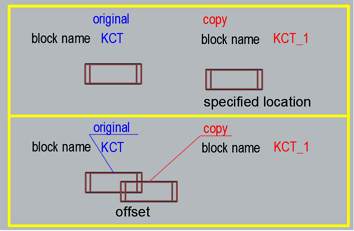

I would like to preserve the functionality of Lee Mac's code by simply inserting a copy of the block in the specified location and leaving the renaming. Or move the copy relative to the original, if that makes it easier... - Today

@mhupp I use Bricscad V25 and it did not work ? Old name stayed there did I miss a step. I tried old fashioned method, it may not be the best solution, if block has attributes then could add a extra sub function to copy the existing values to the new inserted block. Also wants a "Does block exist check". ; https://www.cadtutor.net/forum/topic/99155-insert-a-copy-of-the-block-at-the-specified-point-copyrenameblockv1-5lsp-lee-mac/ ; rename a existing block to a new name ; By AlanH June 2026 (defun c:AHRenblk ( / attreqold bname ent entg inspt oldangdir oldangunits rot scx scy) (setq attreqold (getvar 'attreq)) (setq attreq 0) (setq oldangunits (getvar 'aunits)) (setvar 'aunits 3) (setq oldangdir (getvar 'angdir)) (setvar 'angdir 0) (setq ent (car (entsel "\nPick block to rename "))) (setq entg (entget ent)) (setq bname (cdr (assoc 2 entg))) (setq inspt (cdr (assoc 10 entg))) (setq scx (cdr (assoc 41 entg))) (setq scy (cdr (assoc 42 entg))) (setq rot (cdr (assoc 50 entg))) (setq newname (getstring T "\nenter new block name ")) (command "Bedit" bname "Bsaveas" newname "N" "Bclose" "S") (command "erase" ent "") (command "-insert" newname inspt scx scy rot) (setvar 'aunits oldangunits) (setvar 'angdir oldangdir) (princ) ) (c:AHRenblk) Yes will see flash on screen as Bedit is called. - Yesterday

No error handling. just copies existing block and updates name and insertion point. change 0.0 0.0 0.0 to what you want or use getpoint. ;;----------------------------------------------------------------------------;; ;; Rename Block to New point ;; https://www.cadtutor.net/forum/topic/99155-insert-a-copy-of-the-block-at-the-specified-point-copyrenameblockv1-5lsp-lee-mac/ (defun c:CopyRenameBlock (/ ent obj newobj ed newname) (vl-load-com) (if (setq ent (car (entsel "\nSelect block: "))) (progn (setq obj (vlax-ename->vla-object ent)) (setq newobj (vla-copy obj)) (setq ed (entget (vlax-vla-object->ename newobj))) (setq newname (getstring T "\nNew block name: ")) (entmod (subst (cons 2 newname) (assoc 2 ed) ed)) (entmod (subst '(10 0.0 0.0 0.0) (assoc 10 ed) ed)) ) ) (princ) ) --edit rename Doesn't work -

Do you want to get rid of the "rename only" functionality? If it were me, I'd add the new functionality near the end, after all the validating and bookkeeping is done. In the line with the sssetfirst command (not at that exact spot) the completed copy is added to the current selection set. You could expand that clause to ask for the new location and move the new block from its current location to the new coordinates. Disclaimer: I am only a hobbyist programmer, someone else may find a better solution. -

I need to select a block in the drawing, insert a copy of the block at a specified point, and rename the copy. -

Hi, everybody. In this code, a copy of the block is superimposed on the original, how to change the code to insert a copy of the block at the specified point. ;;-----------------=={ Copy/Rename Block Reference }==------------------;; ;;----------------------------------------------------------------------;; ;; Author: Lee Mac, Copyright 2013 - www.lee-mac.com ;; ;;----------------------------------------------------------------------;; ;; Version 1.5 - 05-07-2013 ;; ;;----------------------------------------------------------------------;; (defun c:cb nil (LM:RenameBlockReference t)) (defun c:rb nil (LM:RenameBlockReference nil)) (defun LM:RenameBlockReference ( cpy / *error* abc app dbc dbx def doc dxf new old prp src tmp vrs ) (defun *error* ( msg ) (if (and (= 'vla-object (type dbx)) (not (vlax-object-released-p dbx))) (vlax-release-object dbx) ) (if (not (wcmatch (strcase msg t) "*break,*cancel*,*exit*")) (princ (strcat "\nError: " msg)) ) (princ) ) (while (progn (setvar 'errno 0) (setq src (car (entsel (strcat "\nSelect block reference to " (if cpy "copy & " "") "rename: ")))) (cond ( (= 7 (getvar 'errno)) (princ "\nMissed, try again.") ) ( (= 'ename (type src)) (setq dxf (entget src)) (cond ( (/= "INSERT" (cdr (assoc 0 dxf))) (princ "\nPlease select a block reference.") ) ( (= 4 (logand 4 (cdr (assoc 70 (tblsearch "layer" (cdr (assoc 8 dxf))))))) (princ "\nSelected block is on a locked layer.") ) ) ) ) ) ) (if (= 'ename (type src)) (progn (setq app (vlax-get-acad-object) doc (vla-get-activedocument app) src (vlax-ename->vla-object src) old (vlax-get-property src (if (vlax-property-available-p src 'effectivename) 'effectivename 'name)) tmp 0 ) (while (tblsearch "block" (setq def (strcat (vl-string-left-trim "*" old) "_" (itoa (setq tmp (1+ tmp))))))) (while (and (/= "" (setq new (getstring t (strcat "\nSpecify new block name <" def ">: ")))) (or (not (snvalid new)) (tblsearch "block" new) ) ) (princ "\nBlock name invalid or already exists.") ) (if (= "" new) (setq new def) ) (setq dbx (vl-catch-all-apply 'vla-getinterfaceobject (list app (if (< (setq vrs (atoi (getvar 'acadver))) 16) "objectdbx.axdbdocument" (strcat "objectdbx.axdbdocument." (itoa vrs)) ) ) ) ) (if (or (null dbx) (vl-catch-all-error-p dbx)) (princ "\nUnable to interface with ObjectDBX.") (progn (setq abc (vla-get-blocks doc) dbc (vla-get-blocks dbx) ) (vlax-invoke doc 'copyobjects (list (vla-item abc old)) dbc) (if (wcmatch old "`**") (vla-put-name (vla-item dbc (1- (vla-get-count dbc))) new) (vla-put-name (vla-item dbc old) new) ) (vlax-invoke dbx 'copyobjects (list (vla-item dbc new)) abc) (vlax-release-object dbx) (if cpy (setq src (vla-copy src))) (if (and (vlax-property-available-p src 'isdynamicblock) (= :vlax-true (vla-get-isdynamicblock src)) ) (progn (setq prp (mapcar 'vla-get-value (vlax-invoke src 'getdynamicblockproperties))) (vla-put-name src new) (mapcar '(lambda ( a b ) (if (/= "ORIGIN" (strcase (vla-get-propertyname a))) (vla-put-value a b) ) ) (vlax-invoke src 'getdynamicblockproperties) prp ) ) (vla-put-name src new) ) (if (= :vlax-true (vla-get-isxref (setq def (vla-item (vla-get-blocks doc) new)))) (vla-reload def) ) (if cpy (sssetfirst nil (ssadd (vlax-vla-object->ename src)))) ) ) ) ) (princ) ) ;;----------------------------------------------------------------------;; (vl-load-com) (princ (strcat "\n:: CopyRenameBlock.lsp | Version 1.5 | \\U+00A9 Lee Mac " (menucmd "m=$(edtime,$(getvar,date),YYYY)") " www.lee-mac.com ::" "\n:: Available Commands:" "\n:: \"CB\" - Copy & Rename Block Reference." "\n:: \"RB\" - Rename Block Reference." ) ) (princ) ;;----------------------------------------------------------------------;; ;; End of File ;; ;;----------------------------------------------------------------------;;
