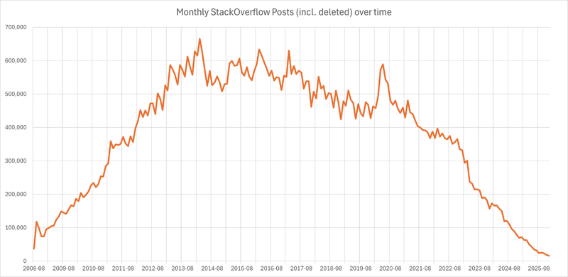

I also think that its AI, especially for new users. I mean AI is good at coding or spotting errors and asking an AI often gets you an answer way faster than starting a forum post. For example here is a chart of stack overflows posts
- Today
I have noticed the drop in posts in forums like Lisp, here, Autodesk and Theswamp, I think it's because people are using AI more to write code. Even I try AI now and again when stuck, it is successful some times. The most obvious here is when the AI code does not work help is asked for here. Maybe Admin could comment about number of posts say compared to 1 or 2 years ago ? Or is it that a lot of new users just don't ask for help ? I know I push for process improvement and have often tried to influence people into saving time but the majority just don't care. Any body else want to comment ?
