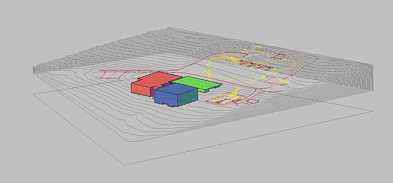

Doove Posted October 6, 2009 Author Posted October 6, 2009 Remark - I'm grateful for your interest, your advice tends to be very sound. I haven't tried PLANESURF yet as I can't really see how that would work. I've attached a pic of model space so you can see what I've done so far. I've converted the 3D polyline contours to 2D closed polyline cross-sections. The bottom one is at z=0. The others are 500 apart in the z. I'm confused as to what Autodesk want me to do for method 1 and 3. Re method 1: I tried opening the polys but no joy. Do they really want me to explode the lot? I suppose I could use groups to select them... Re method 3: I thought planesurf created planar surfaces - how is this going to create my 3D mesh? Quote

Doove Posted October 7, 2009 Author Posted October 7, 2009 I'm getting some "not valid entities" error messages. I'm working from the top down. How were the contours created in the first place? Surveyor gave us a 3D topo that used 3D polylines for everything. I took the contours, exploded them and turned them into 2d closed polylines. 3D polys can't be used as cross-sections in loft. At the moment I'm creating regions for each boundary to try and get around the self-intersecting problem. Quote

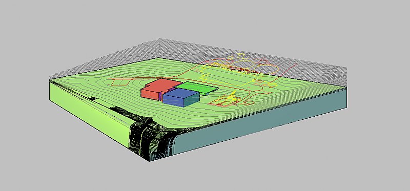

Doove Posted October 7, 2009 Author Posted October 7, 2009 UPDATE FOR ANYONE TRYING SIMILAR THING: I'm having a great time here. Keeps making bloody autocad CTD. After much mucking around; used boundary to create new 'clean' polylines and regions for first 8 contours. Using polys loft worked for first 5!!!! Then would only do 2 at a time BUT DID DO IT - took an unholy length of time punctuated with many CTDs. Using the regions either CTDs or gives very strange results. Have triEd planesurf - no idea what autodesk are suggesting there, just doesn't work. Tried edgesurf & rulesurf too but these don't give the smooth fit I want, though increasing surftab1 & 2 could approimate something more worthy. Have just now tried the surface loft as suggested by shift1313, this seems to be the best approach so far - thanks shift! It'll do about 5 at a time, though I've only just noticed my isolines are set to 18, 18; 3 times the default of 6,6, so this may be slowing things up. Yes it takes forever! The plan at the moment is to add thickness (0.01) to the multiple surfaces then union them. I'll then extrude a primitive up to the surface and union that. I don't anticpate any problems, it's been sooo easy so far what could possibly go wrong... pray for me... Quote
Doove Posted October 7, 2009 Author Posted October 7, 2009 OK - you can stop laughing, I now understand you can't actually DO ANYTHING with surfaces. Can't join, can't thicken, can't trim/extend a solid to them, can't extrude them, etc. Quote

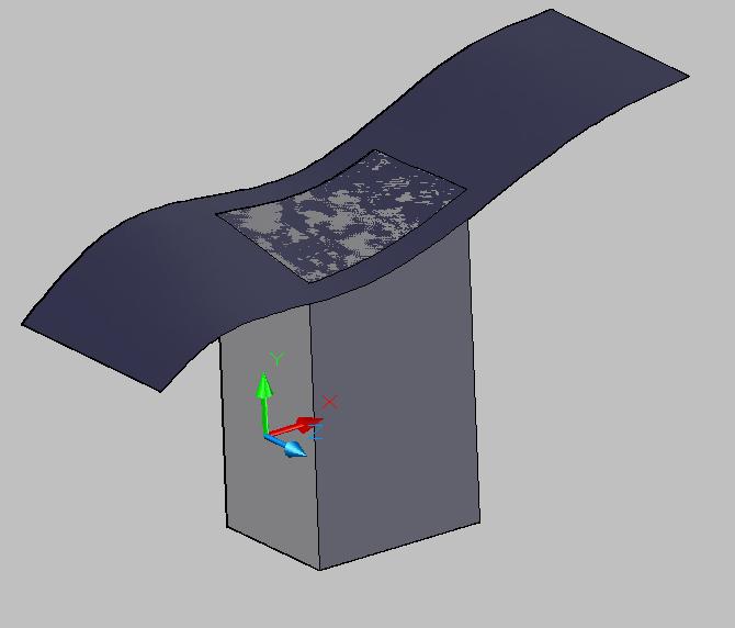

shift1313 Posted October 7, 2009 Posted October 7, 2009 you can convert surfaces/solids in acad07 or newer. If you end up using meshes(dont recommend) you can use the m2s(mesh to solid) lisp which will extrude from your mesh in the z direction using your mesh to trim. Here is a quick example for you. Its a lofted surface using two curves and two straight line guides. I then created a box that went through the surface and used the slice command to slice my solid with a surface. You can also thicken your lofted surface to make it a solid, or if you close the surface with other surfaces you can convert that to a solid. Quote
