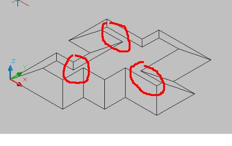

J S Machine Posted October 21, 2009 Posted October 21, 2009 Found this vid on youtube. Seems simple enough. I can't hardly see the drop down menus, and I am using 2009. I have the basic shape of the roof drawn out, but when it comes to the extruding part I lose them. Any hints? h t t p://www.youtube.com/watch?v=2OHx4a-3VBQ note, had to put spaces in the http above so that it would let me post it. It is not spam lol. Quote
stevsmith Posted October 21, 2009 Posted October 21, 2009 he has used the extrude command and added a taper. Follow the command line prompts Quote
J S Machine Posted October 22, 2009 Author Posted October 22, 2009 he has used the extrude command and added a taper.Follow the command line prompts I tried to do exactly what he did, but instead of my geometry extruding towards the center, it extruded into a bunch of different angles. Quote
kencaz Posted October 22, 2009 Posted October 22, 2009 I tried to do exactly what he did, but instead of my geometry extruding towards the center, it extruded into a bunch of different angles. Use PEDIT to join the roof lines before you extrude or each line will extrude as a surface. KC Quote
stevsmith Posted October 22, 2009 Posted October 22, 2009 pedit will only convert 1 line into a polyline. Use mpedit (type into command line) and select all the lines Follow the command prompts. Convert arcs and lines to plines? Yes Enter option: Join Fuzz = 0 Exit. It saves you having to join them all together. Quote
stevsmith Posted October 22, 2009 Posted October 22, 2009 When drawing in 3d it is better to draw lines using a pline and not a standard line. Quote
J S Machine Posted October 22, 2009 Author Posted October 22, 2009 Thanks for you folk's replies. That got me to a certain point, but there is still something being done to the geometry to make everything meet correctly. Before I knew about the polyline deal, I noticed that when I went to extrude it said something like "11 objects selected". After doing the mpedit command I see it only has "1 object selected". Everything works now like it should, but as I bring the roof up I can only go so far. If I go past 4.5 feet it tells me "unable to extrude" . I notice in the video that he only brings his up to 2 feet I believe, and then he does some sort of other command before he brings everything up and all the angles meet to make the apex of the roof. Please excuse my ignorance guys, I'm new to this. I have a book ordered to help me with alot of the basics but it won't be here for a week or two. Here's what I have so far. This is the roof extruded up to 4.5 feet- Quote

stevsmith Posted October 22, 2009 Posted October 22, 2009 Basically if you go higher than 4.5 feet the points then the extrude would clash int other exctruded points and turn itself inside out. I have highlighted the problem areas. They are to close to each other and would clash. Hope that explains it. Quote
ReMark Posted October 22, 2009 Posted October 22, 2009 Sounds like you need to change the roof pitch to go higher. Quote

J S Machine Posted October 22, 2009 Author Posted October 22, 2009 Sounds like you need to change the roof pitch to go higher. I'm going to try this. Maybe he is doing something to the roof and changing the pitch. I thought it looked a little flat. Quote
stevsmith Posted October 22, 2009 Posted October 22, 2009 he has edited the top face of the roof. Do the following from the dropdown menu. Modify Solid Editing Move faces Select the top face and move the cursor up this will strech the roof up to its apex. Quote

J S Machine Posted October 22, 2009 Author Posted October 22, 2009 he has edited the top face of the roof. Do the following from the dropdown menu. Modify Solid Editing Move faces Select the top face and move the cursor up this will strech the roof up to its apex. I just figured this out. The only thing that I don't like is that as you move the lines closer, it pulls the outside edges in as well. Trying to figure out a way to get around this. Quote
