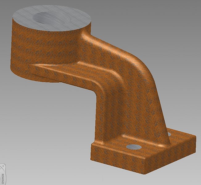

Glen Smith Posted November 17, 2009 Share Posted November 17, 2009 A DWF file is a file format that people use to send copies of drawings to other people. It is designed so that although the file may be viewed in full detail, it can not easily be edited. I have attached a screen shot of the part that JDMather drew rendered and posted in DWF. Glen Quote Link to comment Share on other sites More sharing options...

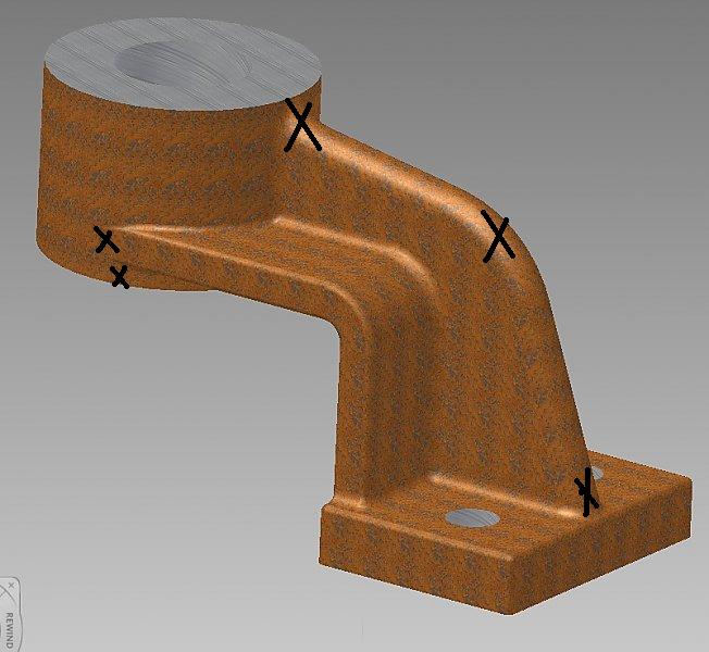

cute eng Posted November 17, 2009 Author Share Posted November 17, 2009 A DWF file is a file format that people use to send copies of drawings to other people. It is designed so that although the file may be viewed in full detail, it can not easily be edited. I have attached a screen shot of the part that JDMather drew rendered and posted in DWF. Glen thank u glen but how i do the X i put it in the pic ? i know i can use ( fillet ) but in which point ?? Quote Link to comment Share on other sites More sharing options...

JD Mather Posted November 17, 2009 Share Posted November 17, 2009 but how i do the X i put it in the pic ? That is part of the missing information. This part cannot be made from the information you were given. Someone will have to make some educated decisions about fillets, face draft angles and other Design for Manufacturability parameters. Quote Link to comment Share on other sites More sharing options...
Glen Smith Posted November 17, 2009 Share Posted November 17, 2009 I don't know how far along you are, so I can't really tell you which lines to select to perform the fillet command. In general, you start the fillet command, select r for radius, specify the radius, then click on the first line, then the second line. Glen Quote Link to comment Share on other sites More sharing options...

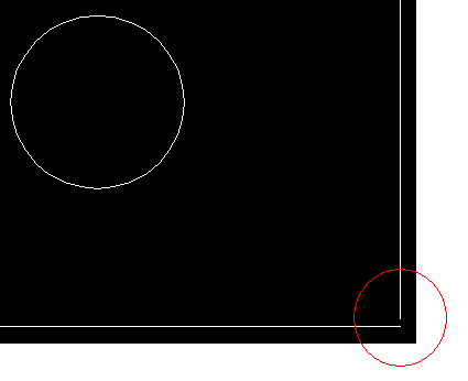

cute eng Posted November 17, 2009 Author Share Posted November 17, 2009 That is part of the missing information. This part cannot be made from the information you were given. Someone will have to make some educated decisions about fillets, face draft angles and other Design for Manufacturability parameters. ohhh you are right now i check 125 + 28 only to the centre so we must add 40 thank u very much i reach until here see the attachment can i fix it ?! without remove what i made ?? h.w6.dwg Quote Link to comment Share on other sites More sharing options...

JD Mather Posted November 17, 2009 Share Posted November 17, 2009 can i fix it ?! without remove what i made ?? Well, it would be quite easy to fix if your professor had given you some instruction on orthographic projection (or maybe you missed that class?). Move, stretch, trim/extend will be your friends. Check the location of those holes as well. And watch out for garbage like this (see attached). Autodesk Inventor would set you straight on that real quick. Quote Link to comment Share on other sites More sharing options...

cute eng Posted November 17, 2009 Author Share Posted November 17, 2009 Well, it would be quite easy to fix if your professor had given you some instruction on orthographic projection (or maybe you missed that class?). Move, stretch, trim/extend will be your friends. Check the location of those holes as well. i didnt know how to make it can u make it please ? only fix the width and make it 193 coz i made it 153 Quote Link to comment Share on other sites More sharing options...
