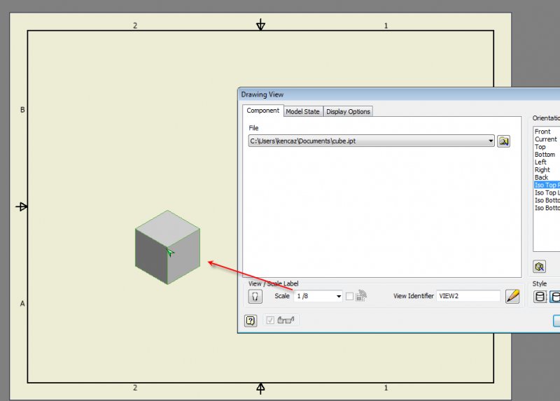

kencaz
Yes, scale in your idw or (dwg) if you prefer to 1/8

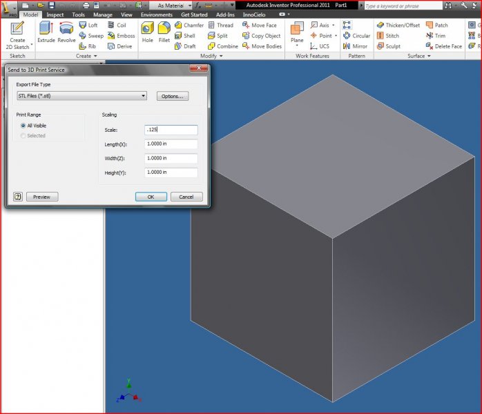

jdits7
If I am reading this correct, you want to print this on a 3D printer. If that is the case go to the Inventor Menu in the upper left hand corner, go down to Print, go to Send to 3D Print Service, then a dialog box will pop up and there you can set the scale that you want it printed in. Pic to show dialog box.
