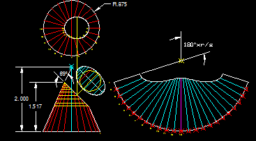

Tankman Posted March 1, 2011 Posted March 1, 2011 (edited) Take a look around http://www.cadforum.cz/catalog_en/?cat=21&page=3 you may find something you can use. Sure sounds like a cone to me(?). A transition might be a square to round. Then take a peek-a-boo here http://www.sheetmetalworld.com/sheet-metal-news/fabrication-tutorials/22-sheet-metal-tutorials/5961-learn-how-to-layout-a-cone-in-sheet-metal. Edited March 2, 2011 by Tankman Quote

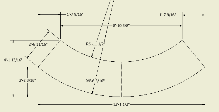

JD Mather Posted March 2, 2011 Posted March 2, 2011 Here is the actual corner in a 3D model. A sheet metal part is generally cut with edges perpendicular to flat - uniform thickness, therefore the geometry shown. Quote
JD Mather Posted March 2, 2011 Posted March 2, 2011 I've got to run, but unless I made a serious mistake (and I doubt that) the dimensions the transition help.dwg file are way off. The program I used calculated bend allowance which would account for some of the difference, but I don't think the bend allowance is that much. I'll check tomorrow to make sure. Quote
SEANT Posted March 2, 2011 Posted March 2, 2011 For the larger arc I’m getting the two extremes at approximately 9’-10 1/16” and 9’ - 11 ¼”. 9’ – 10 5/8” seems to account for a neutral axis at about the midway point. Quote
