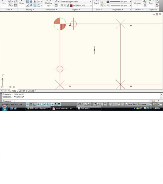

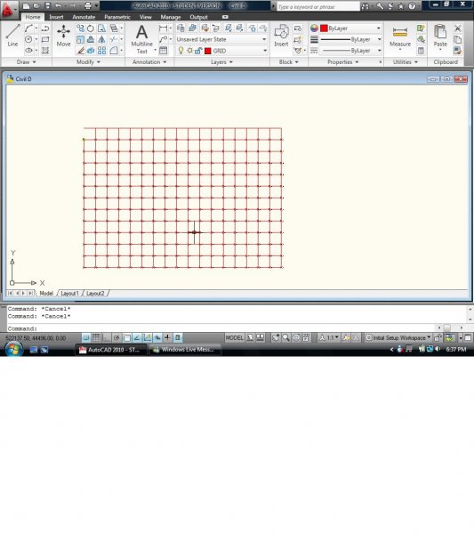

Its me again with more questions. can you guys take a look at this image and tell me if am going in the right direction? am asking this assuming you guys have seen this before.
Share this post
Link to post
Autocadstudent
here it is:
Share this post
Link to post
Organic
I have no idea what you are trying to do. Perhaps post the assignment details or more info.
So far it looks like you have drawn a (nearly complete, missing line top left corner) grid.

Autocadstudent
Am sorry i forgot to put that. this part of what plate 1 tells me to do.

Car5858
Looks ok except for the missing line near the bench mark.

Organic
From what I can see in your image it looks like you are doing it correctly so far.
