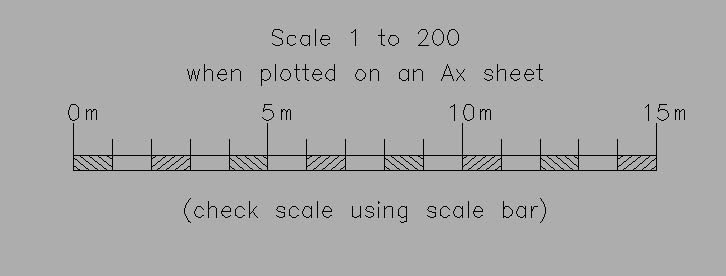

eldon
How much better if you add a scale bar with the note, then folk have no excuse for not knowing :D

Jack_O'neill
Brilliant! Why didn't I think of that? 1000 year old map maker's tool...so very obvious! Does not matter one bit then what the scale is (or is not)!
