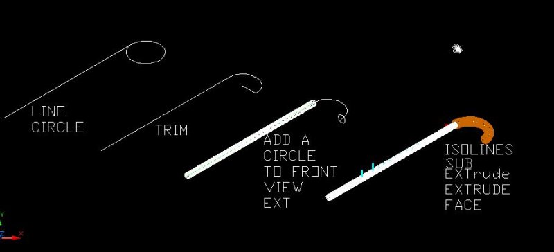

Hi Kencaz and rvpas, I'm only a novice to CAD and was only able to create line A to B, the Pline and Arc. Since class I totally forgot how to do things and definitely need to look back at my notes to practice. I posted an image of how my professor created a cane in class back in 010'. I created the first, second, and third step with the circle, but don't know to finish with the ext and the fourth step? (I also want to add a small equal side box at the bottom of the cane.)

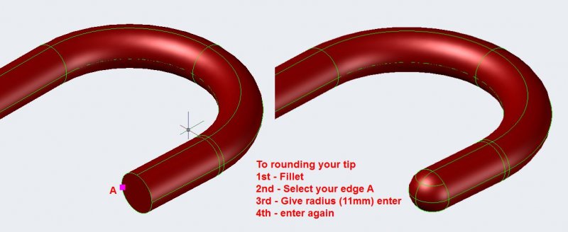

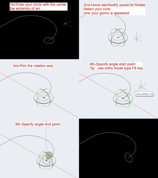

I noticed that your handle was bigger than the tip
In this case you have two solutions
A-Draw 2 profiles instead of the only one and use sweep like I exposed bebore or
B-If have to use only extrude command
see my procedure (I use 3drotate)
And use extrude
Home tab/Modeling/Extrude
1st-select your profile and enter
2nd-select path as option
3rd-select your path

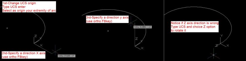

Or before you draw your circle change your ucs
And use extrude

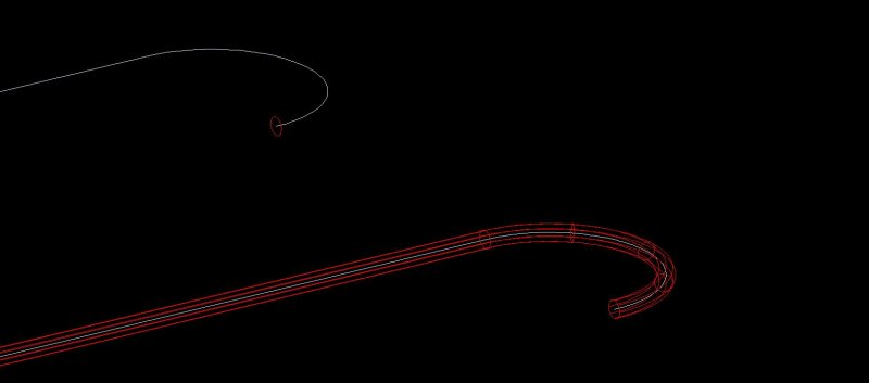

If you are going to EXTRUDE using the PATH option may I make a suggestion? Pedit > Join the line and arc first then EXTRUDE the circle you have positioned there at the end.
Hi,
I typed in pedit, selected the arc, typed in join, and it still said select objects? I typed ext to the circle but it wouldn't allow me to?
The Pedit command is kind of strange. It will continue to prompt the user to "Select objects".
This is what your input and AutoCAD's responses should look like....
Command: pedit
Select polyline or [Multiple]: m
Select objects: 1 found
Select objects: 1 found, 2 total
Select objects: AutoCAD will continue to prompt the user to select objects as you see here.
Enter an option [Close/Open/Join/Width/Fit/Spline/Decurve/Ltype
gen/Reverse/Undo]:
At that last line just cancel out of the command. The line and arc should now be one continuous polyline entity. Now you can EXTRUDE the circle along this path.
Before (line, arc and circle). After (extruded circle along polyline).
