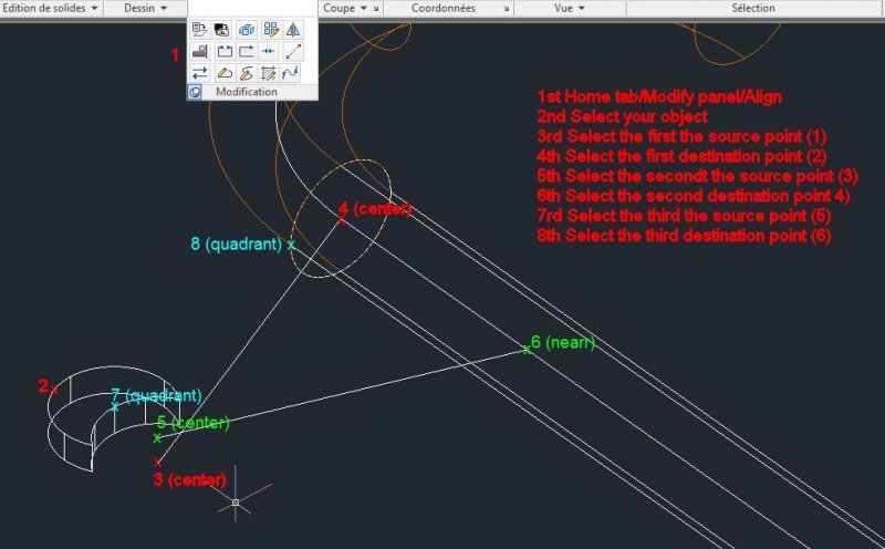

rvpas Posted August 10, 2011 Posted August 10, 2011 Thanks SFG ! You have differents ways to make it, at your place, I will use Align command for your boomerang see procedure Bye Quote
SFG13 Posted August 10, 2011 Author Posted August 10, 2011 Hi rvpas, I tried to follow your steps but it's kind of hard to figure out since some of the steps and numbers are in the same color. I'm not sure where 1 begins, or where 5 and 3 are to be? I just clicked an open area that looked similar in the picture. I tried it many times but the object ended up in different areas not what I intended? I would like the object to appear on the front right side of the cane as it will be a small handle switch, basically the opposite side of the cane close to the bottom of the handle when you see the drawing. arc12.dwg Quote

SFG13 Posted August 10, 2011 Author Posted August 10, 2011 Hi, I was able to get familiar with the align command. Step 3rd says to select the first the source point (1) but I'm not sure what or where is it? I can see destination point 2 in red and so on. I'm not sure where exactly 3, 5, and 6 are supposed to be? Do I just select an area slightly below the handle where the cursor pauses at a certain point? Quote

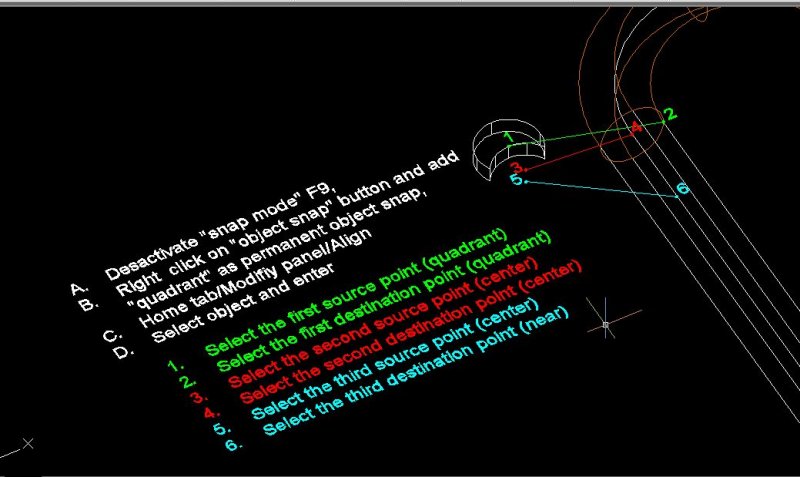

rvpas Posted August 10, 2011 Posted August 10, 2011 Hi SFG In your case, I change my chronology see image and Include your file with steps arc12-rvpas.dwg I hope to be more clear in my explanations at this time Have a good day Its getting late in france Bye PS Help from autodesk http://docs.autodesk.com/ACD/2011/ENU/filesACR/WS1a9193826455f5ffa23ce210c4a30acaf-5184.htm Quote

SFG13 Posted August 12, 2011 Author Posted August 12, 2011 I also tried following rvpas' steps as everything goes fine until once I get to selecting the third destination point is when it gets odd. Any area I click on the cane will end up a mess. I'm just lost on why it's not working right? arc12.dwg Quote

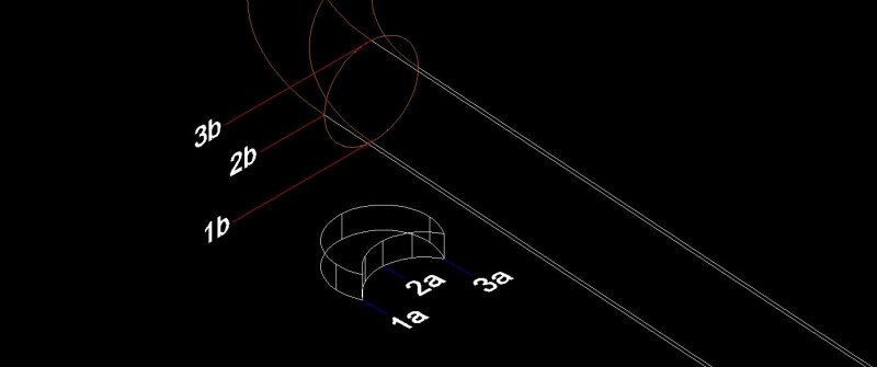

ReMark Posted August 12, 2011 Posted August 12, 2011 The first thing I noticed was you do not have "quadrant" selected as one of your Osnaps. How were you making your picks? Quote
SFG13 Posted August 12, 2011 Author Posted August 12, 2011 Hi, Actually I did select Quadran from the Onsnap button that looks like a box with a small circle. I'm confused? Quote
ReMark Posted August 12, 2011 Posted August 12, 2011 Look at the image below. Notice that I've labeled the three points (all quadrants) on the arc as 1a, 2a and 3a. Each of these quadrants must be matched up with three quadrant points on the cane (labeled 1b, 2b and 3b). ALIGN 1a to 1b, 2a to 2b and 3a to 3b. Quote

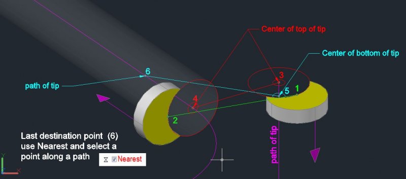

rvpas Posted August 12, 2011 Posted August 12, 2011 Hi SFG, The third destination point (6) I use Nearest Osnap and I select the path to give the last direction. see image and file include arc12-rvpas-2.dwg Quote

rvpas Posted August 12, 2011 Posted August 12, 2011 Hi SFG, Do you know Nearest Object snap ? I use this kind of Object snap to select a point along line or edge. At point 6 - hold down Shift and right-click et select NEArest and move your cursor along your line (path tip) and click on it. You do not need to select a particular point with this kind of object snap. Quote
