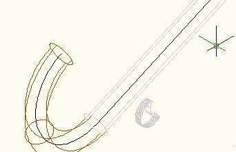

SFG: Please go back and see post #75 where I use the ALIGN command. Pick the points, one on the arc and one on the cane, and continue to do so until three points have been picked on the arc and cane. It is as simple as that. I have now done this at least three if not four times and it works each time. I think you are not zooming in close enough to visualize the correct points and that's why you get weird results. You must also have your Osnaps enabled and pick ONLY the QUADRANT points.

Using ReMark's instructions, I displayed pictures of what quadrants I clicked in order from 1a, 1b, 2a, 2b, 3a, 3b, the last step picture is the one that goes berserk????!! Tell me what I'm not following right or am I just a numb-skull??? :?

Do us a favor...turn SNAP off. And while we're at it why is everything being drawn on layer "0" and why are you overriding the assigned color? Didn't we talk, in the past, about the practice of setting up layers and assigning them different colors so it is easier to work in the drawing? Haven't you forgotten these important points?
Lets skip the use of the Align command and try something different why don't we? Reorient you UCS. Draw the arc in 2D in its proper location relative to the shaft of your cane then use either the EXTRUDE or PRESSPULL command to create the 3D object. You do know how to manipulate the UCS don't you?

Your last attempt should have worked so I am at a loss to understand why it did not. The only thing I can think of is that it had something to do with SNAP/GRID being enabled but the more I think about it the less I am convinced that is true.
I went back and took a look at the last arc drawing you posted. It's all screwed up again. Your UCS is out of whack and the curved portion of your cane does not line up with the straight portion. That might explain why you are getting strange results with the ALIGN command. I thought we had this all fixed at some point? We're not making any forward progress; we're going backwards. Did you post the wrong drawing (maybe an early attempt)? Perhaps you would benefit from the creation of a X/Y/Z reference set of lines created in the lower left-hand corner of model space that you can easily refer back to and get your UCS correctly lined up on (via the 3-point method). I don't know how you continue to twist the UCS at weird angles. This practice has to stop or you'll be constantly redrawing your objects trying to fix problems that are self-inflicted.
