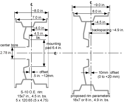

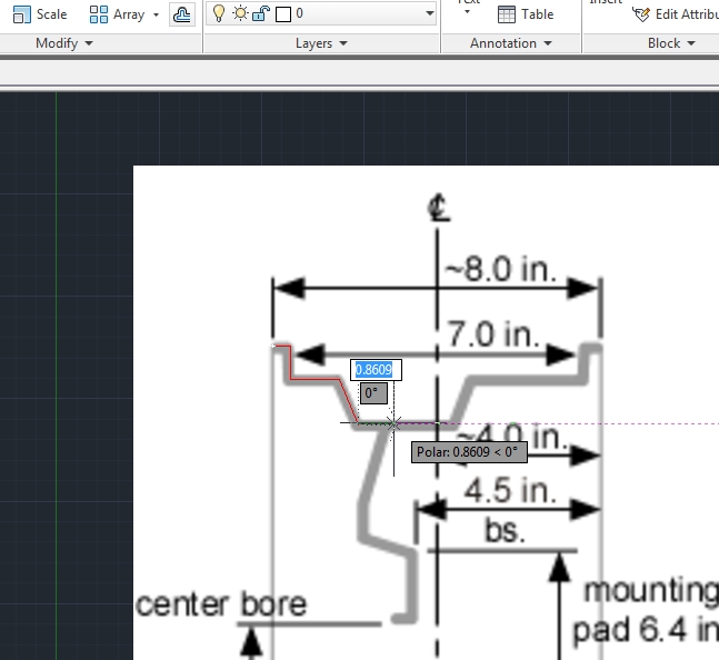

f700es Posted October 6, 2011 Share Posted October 6, 2011 Yes it was an offset and then I did a trim to connect the lines and then a pedit to connect and join them. Here is the image I used. I used the left image. Brought it into Acad. Scaled it to be close to scale as possible. Drew a line on the wheel profile and then offset, trim, pedit. Used the dims on the image to get my center line, offset 1.39 from the wheel edge. Quote Link to comment Share on other sites More sharing options...

SLW210 Posted October 7, 2011 Share Posted October 7, 2011 Post an image with dimension of the wheel you wish to make. Quote Link to comment Share on other sites More sharing options...
f700es Posted October 7, 2011 Share Posted October 7, 2011 lol i messed my rim. due to lack of dimesion cant figure out how to make a perfect dimension or lenght or width You are making it too complex. Just trace over the lines and make it close enough. Quote Link to comment Share on other sites More sharing options...

f700es Posted October 7, 2011 Share Posted October 7, 2011 Remember that you need a line offset from the center-edge to use as a revolve center line. Look at my original images on page 1. Edit: No need to post the dwg a jpg will be fine for right now Quote Link to comment Share on other sites More sharing options...

SLW210 Posted October 7, 2011 Share Posted October 7, 2011 Draw the profile for the tire and revolve same as you did for the rim. Quote Link to comment Share on other sites More sharing options...
