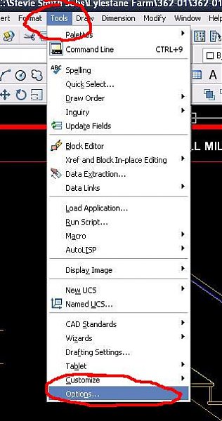

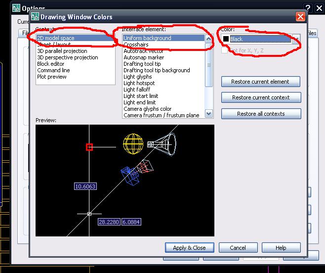

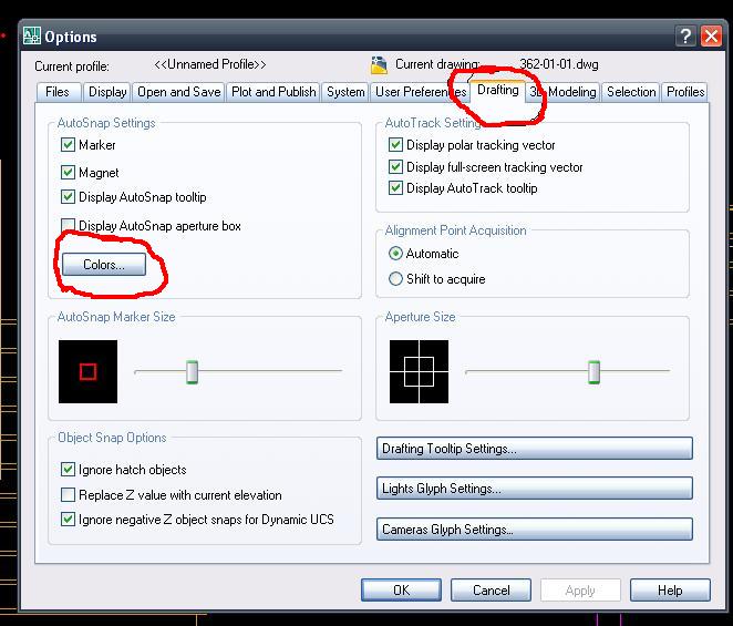

To change the background to white, just untill youget used to it.
