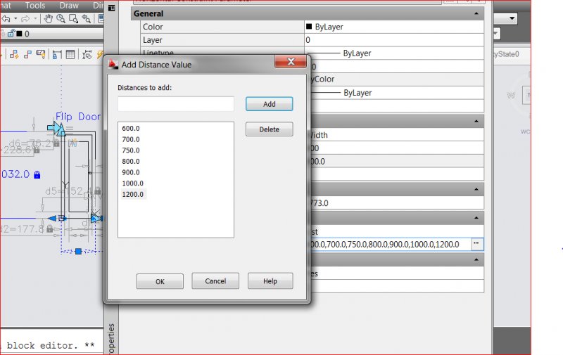

MemberX Posted February 24, 2012 Author Share Posted February 24, 2012 Maybe this will help thanks nestly ....... but in my drawing width is 1m I want to draw 1.2m Quote Link to comment Share on other sites More sharing options...
ReMark Posted February 24, 2012 Share Posted February 24, 2012 It's a "Custom" width. What is preventing you from adding one for 1.2m? Quote Link to comment Share on other sites More sharing options...
MemberX Posted February 24, 2012 Author Share Posted February 24, 2012 ^the option under the arrow head is .6,.8,.9, 1.0 1 is the maximum width........ Quote Link to comment Share on other sites More sharing options...
ReMark Posted February 24, 2012 Share Posted February 24, 2012 Can't a 1.2m door width be added via the BEDIT (Block Editor) command? Quote Link to comment Share on other sites More sharing options...
SLW210 Posted February 24, 2012 Share Posted February 24, 2012 You need to do this in the block editor. I have spelled out the instructions along with visual aid in the posts previous. Quote Link to comment Share on other sites More sharing options...
MemberX Posted February 24, 2012 Author Share Posted February 24, 2012 SWL210 see if i am choosing 1200 it is not selected at all? Quote Link to comment Share on other sites More sharing options...
SLW210 Posted February 24, 2012 Share Posted February 24, 2012 I haven't a clue what you are trying to do, it is already added. What else are you wanting? Quote Link to comment Share on other sites More sharing options...
ReMark Posted February 24, 2012 Share Posted February 24, 2012 I just answered my own question by adding a new width to the Door Elevation - Imperial dynamic block using the BEDIT command. Works like a charm. Quote Link to comment Share on other sites More sharing options...
MemberX Posted February 24, 2012 Author Share Posted February 24, 2012 I haven't a clue what you are trying to do, it is already added. What else are you wanting? after that what i have to do?how can I change it?By using arrow ,all geometry has been changed. Quote Link to comment Share on other sites More sharing options...
ReMark Posted February 24, 2012 Share Posted February 24, 2012 In BEDIT... If you click on the Width this will open up the Horizontal Constraint Parameter. Change the value opposite the word "Expression" and then move your cursor back into the drawing area and the door width should change. Save your changes and exit the Block Editor. Back in your drawing click on the dynamic door block and in the Block Reference window, under the Width drop-down, should be your new value. Quote Link to comment Share on other sites More sharing options...

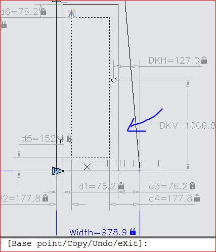

MemberX Posted February 24, 2012 Author Share Posted February 24, 2012 this is what happened Quote Link to comment Share on other sites More sharing options...
nestly Posted February 24, 2012 Share Posted February 24, 2012 Like this... [video=youtube;ZRJKl-CF688] Quote Link to comment Share on other sites More sharing options...
ReMark Posted February 24, 2012 Share Posted February 24, 2012 I just did it using the metric dynamic door elevation block and all I did was change the expression to 1200. Works like a charm. Wouldn't you want to use 2100 not 2.1? Quote Link to comment Share on other sites More sharing options...
MemberX Posted February 24, 2012 Author Share Posted February 24, 2012 I am really frustrated I did the same ,added 1200 then close block.... save changes to block then..again it is not showing 1200.... Quote Link to comment Share on other sites More sharing options...
ReMark Posted February 24, 2012 Share Posted February 24, 2012 I do believe I was able to recreate your problem. I opened a new template which just happened to have be in imperial units then inserted the Metric - Door Elevation. I think you are not using a metric template. The default door widths included in the metric version of the Door Elevation dynamic block should be 600, 700, 750, 800, 900 and 1000. Look at the width indicated in the last image you posted. To me that says "imperial" not metric. Don't you agree? Update I have just verified that the issue can be resolved by using a metric template. I was able to successfully add a door width of 1200 to the default values I previously listed. Quote Link to comment Share on other sites More sharing options...
SLW210 Posted February 24, 2012 Share Posted February 24, 2012 The file you posted is Imperial. Use the Metric Door and set the width options as shown above. This was post #14, I guess I should have added to use a metric template as well. Before jumping into dynamic blocks, maybe you should work a little more on drawing set ups, Insertion Units, Drawing Units, etc. and creating custom templates. There are several tutorials covering all of this in the tutorials section of CADTutor. Quote Link to comment Share on other sites More sharing options...

MemberX Posted February 25, 2012 Author Share Posted February 25, 2012 No toes stepped on. I was reminding the OP that all of this has been gone through. OP is trying to fly a Leer jet without learning to fly a Cessna, seems to me. I did the sample I posted in a Metric Template, what happened to that? I am not trying to flying.I'm not impatient person.I have to finish it on times . that's it ....... I have drawn in metrics only... It shows 1200,width and h=2100 in bedit but this is not actually working in model...All dimensions changes even if i have saved it in block. Quote Link to comment Share on other sites More sharing options...
