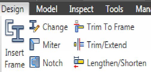

JD Mather Posted March 25, 2012 Posted March 25, 2012 (edited) AutoCAD Architecture runs on top of AutoCAD - so AutoCAD commands will work as well. Looking at your problem in the picture you attached it is purely a geometry problem to me. These various tools (AutoCAD Archicture, Revit, Inventor...) have optimized tools for specific fields (architecture, mechanical...) while AutoCAD is more general purpose. In any case your job will be to scale the 3D learning curve in one of them. As is see this as a geometry problem, and as putting together the building is a matter of assemblying manufactured parts and on-site cutting (manufacture?) and as I know Inventor better than the other CAD programs - I could do this relatively easy in Inventor especially using the Frame Generator with custom profiles of standard lumber. So the job is to pick the geometry tool that will be easiest for you to use in the majority of your projects and simply adapt techniques for your specific use that perhaps it wasn't optimized for (in my case adapting Inventor which I normaly use or mechanisms for architectural projects). I would consider it something akin to torture to go back to AutoCAD for a design such as your picture depicts. Edited March 31, 2012 by JD Mather Quote

fostertom Posted March 31, 2012 Author Posted March 31, 2012 Thanks JD and Pablo. Parametrics is a point. I would love to create vast parametrics, so moving one thing would ripple thro the whole building - but know that's not possible. Short of that, I don't yet see (tell me!) how parametrics would help. 'Frame Generator with custom profiles of standard lumber' - presumably parametric? - but cuboids are so easy to create on the fly, or copy from nearby. Then those cuboids only get re-sized by boolean intersection with another cuboid, in situ, not as a component before installation. Because of this 'cut to fit in situ' procedure, in building almost every object is unique. The reverse perhaps of mech eng. In building you kinda start at Assembly level, shape all the components there, in situ, then maybe you look at Component level to see how they've ended up. In 2D Acad 2006, I've learned to avoid making standard components as Blocks, because of many inflexibilities and annoyances that Blocks create - e.g. won't move with a Stretch, won't allow a linetype scale change if part of the selection, the slowness of entering and exiting blocks to edit them. So I am suspicious of Components! Quote
JD Mather Posted March 31, 2012 Posted March 31, 2012 ... but cuboids are so easy to create on the fly, or copy from nearby. Then those cuboids only get re-sized by boolean intersection with another cuboid, in situ, not as a component before installation. Because of this 'cut to fit in situ' procedure, in building almost every object is unique. ... I am not a beginner. Not in Inventor. Not in AutoCAD. Quote
