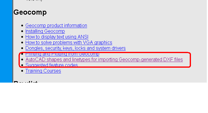

When I tried to open that file, it pops up the shx dialog box because geocomp.shx wasn't on my system. If I hit cancel, it opens the drawing. If I create the dxf at this point, I get the same error message you reported in your original post.
You will need to go here: http://www.geocomp.com.au/support/ and download that geocomp.shx shape file. Put it in your Autocad fonts folder, then create your dxf file. Should solve your problem. Worked on my system.

When you get to the geocomp page in my previous post this is the link you'll need to get the download:
