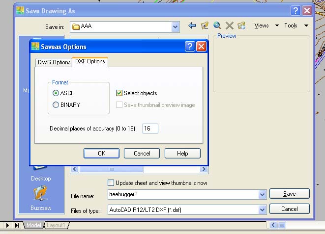

When you hit the SaveAS button and a dialogue box comes up. (I have an earlier version than you, so perhaps the picture isn't exact). At the bottom you select Files of type - AutoCAD R12 DXF. At the top of the box at the right hand end is Tools. Select that and choose Options (at the bottom of the list). Then select DXF Options and select the "Select objects". Then press OK and you will be invited to select objects. Window the whole drawing, and there you are :)
