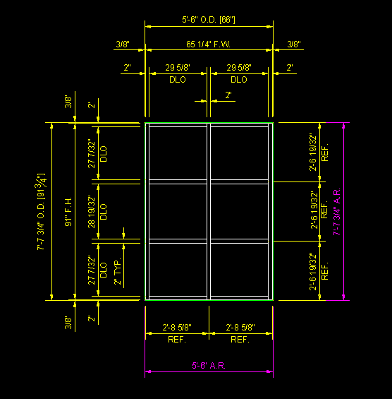

Jack_O'neill Posted March 10, 2012 Share Posted March 10, 2012 The subject of this discussion is why there are usually 2 sections in each file....one folder labeled "design" and one "as-built". I don't do much residential stuff, almost all of my work is on commercial buildings, and 90% of what I do are the curtain wall elevations and details. These elevations are generally dimensioned like this: Curtain wall is a little strange, and follows it's own path, but nearly everything gets dimensioned more than once so that there's no question about where it should go. OD in this case means "opening dimension", not outside diameter. FW is frame height, AR is "architectural reference". As you can see, the actual framing members are measured from the outside of the first to the centers, then to outside of the last. DLO means "daylight opening" and means just that...it's the amount of space daylight can pass through. The 3/8 dims you see at the top and bottom and each side is the caulk joint that goes all the way around the system. Confused yet? Quote Link to comment Share on other sites More sharing options...
