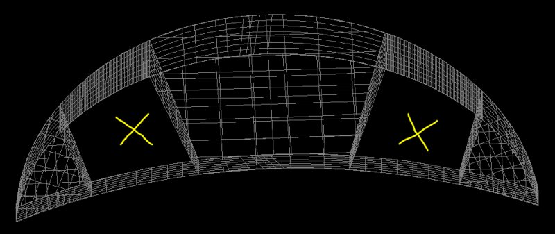

I am a C3D guy but am trying to help out a buddy and create this object for him. I need to get the model into a .stl format so he can get it prototyped. I have lots of surfaces but I need to connect, combine, merge, glue, tape, them together to form a solid object and I really have no idea how to do that.
I have attached the dwg for viewing for it will probably paint a clearer picture.

I'm sure there are. It took me hours to create this object. This was my first time ever (no training or help) trying to draw a 3d object.
If you make a copy of the object>delete the surfaces, all you will see are plines, 3dplines, arcs, etc. I am sure I did not draw this the easiest way. I did everything manually. To where I am now (a busted model) probably took me 25hrs.
Can you guide me on how to fix the voids? Or even how to tell that I have voids?
