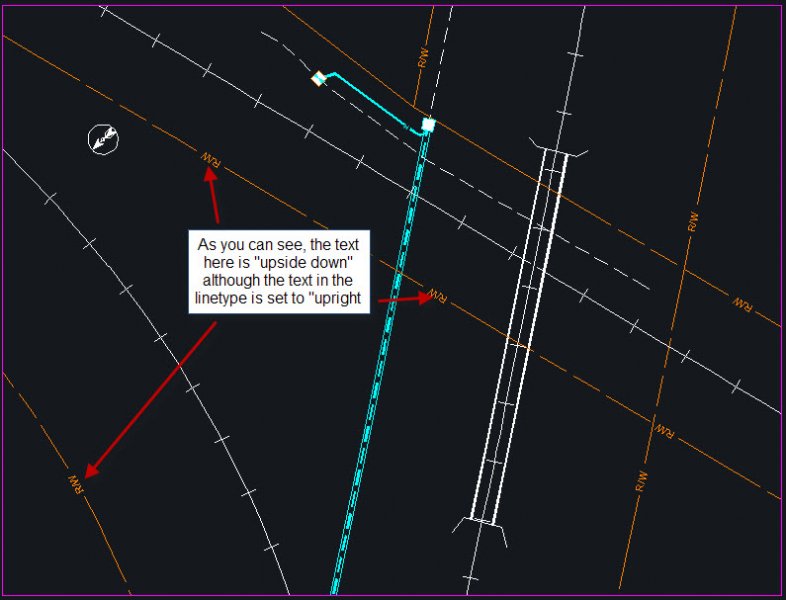

Phaedron Posted May 10, 2012 Posted May 10, 2012 I am having an issue with the "upright" script in my ltype descriptions. Apparently it works the way it is supposed to and not the way I want it to. The upright is set to 0 which orients the text in linetypes to be shown as "upright" to the model space. In most design cases; not an issue, but I am designing construction plans along a roadway and as such, north is not always "upright" to my viewport. Is there a script (ie ...,u=v],... or ...,u=vp],...) that will orient my text based on the line displayed in the viewport? Thanks Quote
MSasu Posted May 10, 2012 Posted May 10, 2012 Can you post a sketch with what you are looking for? Quote
Phaedron Posted May 10, 2012 Author Posted May 10, 2012 Here is the scetch This text is aligned upright or u=0 in the ltype description. Is there a way to get it to realign based on its orientation in the viewport? Thanks Quote
MSasu Posted May 10, 2012 Posted May 10, 2012 (edited) I think that is enough to redraw those lines in other opposite sense; or to rotate them 180degrees around their middle. Edited May 11, 2012 by MSasu Adjusted words Quote
Phaedron Posted May 10, 2012 Author Posted May 10, 2012 The problem is, this is just a smal segment. We do construction drawings for miles in a single project. Often times, we turn city blocks and must orient the drawings where the matchlines align to read from left to right across the page. This means that 50 percent of the time (if not more it seems) the situation of North pointing down or to the right is how we have to show the drawing. My question is: Is there a way to get text in a line to orient correctly through the viewport in Paperspace just as it does in Modelspace. If they can do it with annotation, why not orientation. Thanks Quote
MSasu Posted May 10, 2012 Posted May 10, 2012 The best automation I can think on is an AutoLISP routine: ; Reverse Line Sense (10-V-2012) (defun c:RLS( / itemSet assocItem ) (while (setq itemSet (ssget "_:S:E" '((0 . "LINE")))) (setq assocItem (entget (ssname itemSet 0))) (entmod (subst (cons 11 (cdr (assoc 10 assocItem))) (assoc 10 assocItem) (subst (cons 10 (cdr (assoc 11 assocItem))) (assoc 11 assocItem) assocItem))) ) (princ) ) Quote

MSasu Posted May 11, 2012 Posted May 11, 2012 The string part of linetypes is aligned with OCS (Object's Coordinates System) - for lines axis X means that origin is first vertex, while the second one establish the positive direction. So, the same line will bear normal text when drawn from left to right, and upward when drawn inverse. Quote
