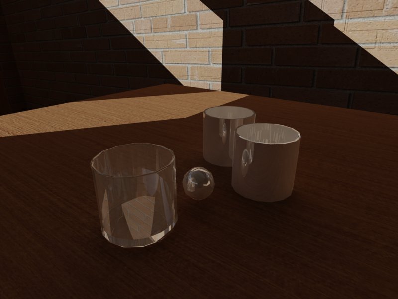

3D Round Objects showing multiple flat faces
FernandoLucchesi
So, that's how it is configured:
FACETRES = 10
VIEWRES = 20000
SPLINESEGS = 200
ISOLINES = 20
DISPSILH = 0

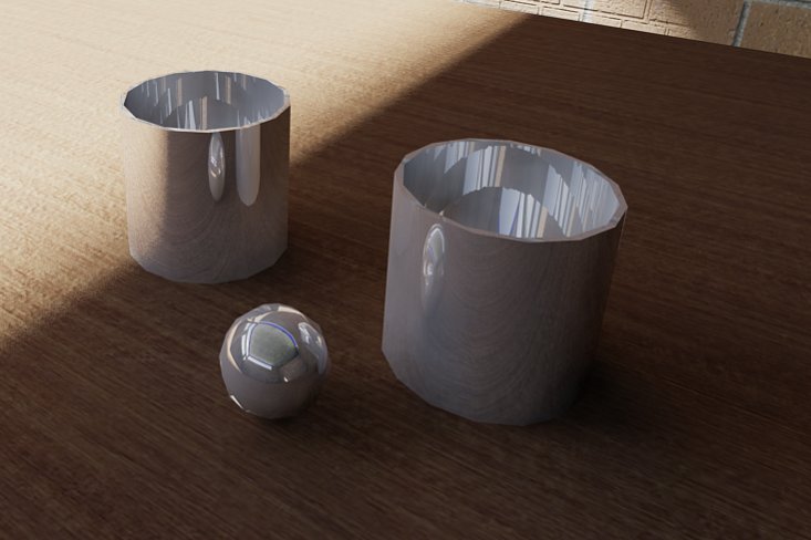

So, I started to mess around, changed the textures to a "Chrome like", and seems there was an significant improvment with the faces, but the edges are still giving it away... Take a look:
I am to the conclusion that something else is weird about your file that I cannot pinpoint. I can't even get the UCS to go to World and the NavCube align properly. I can't use Dynamic UCS at all, and there are some very strange boxes that hover around the 3D table that I've never seen. I did a copy/paste origin to origin into a fresh template and it all rendered just fine.
See if you can't do the same.

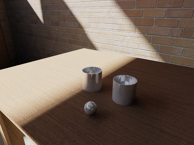

Just did a copy/paste to a new file, reset the location, time, sun and rendered... Here is the result...
Not much of a progress... =(

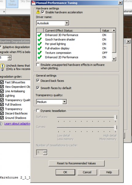

And you are absolutely sure that Dynamic Tessellation is unchecked under 3DCONFIG > Manual Tune, correct?
Absolutelly... Just to elaborate, i tried with it UNCHECKED and CHECKED with both sliders at full... Both still getting the same results, can you please post your render, so i can see the difference? I'm starting to get really ashamed of keep posting here, because it seems like i'm not getting the results i'm expecting and i'm starting to **** you guys off, so if you tells that my render is the best i'll get, i'll accept that, no worries, i just wanted to see how good it would get, all the help is appreciated, thanks!

We all volunteer our own time so nobody should have any reason to be mad as their involvement is their own choice. And I'm at a loss.... I don't know what is wrong. I cannot recreate the segmented models when I render it so I'm assuming it's an application variable, not a drawing variable, but that's starting to get way above my AutoCAD knowledge.
So, i'm probably stuck with these renders, because i won't be able to configure this application's variable?
Your card does not support hardware acceleration yet you have it enabled. Could that be influencing the results?
My video card is a "EVGA Geforce GTS 250 1Gb", it doesn't support Hardware acceleration?

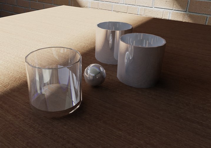

So, just to be safe, i unchecked HARDWARE ACCELERATION and rendered... Let's say it came out something like DOOM 2
One thing i'm wondering; i'm rendering it on "Presentation" quality everytime, because i'm afraid if i render it on medium or high, i'll miss the details on the "round" cup, but it takes too long, the question is: If i render it on medium or high, it'll lose the round details or it has no relation at all and I'll see it round even redering on medium?

I swear that everything points to the setting of FACETRES which controls the mesh density of curved solids. Solids, like your glasses, will appear faceted if the setting is too low. But we have been down this path already so I'm stumped.
