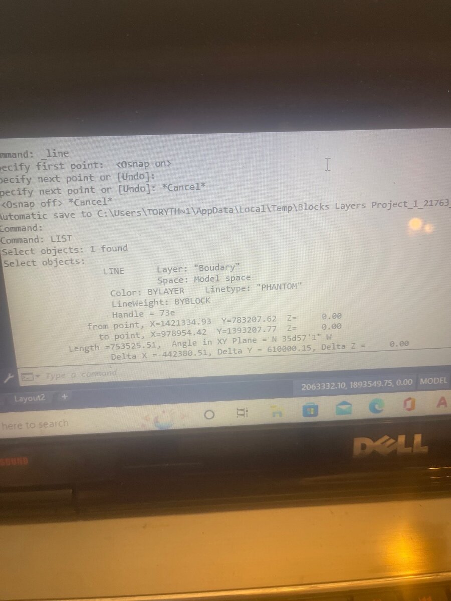

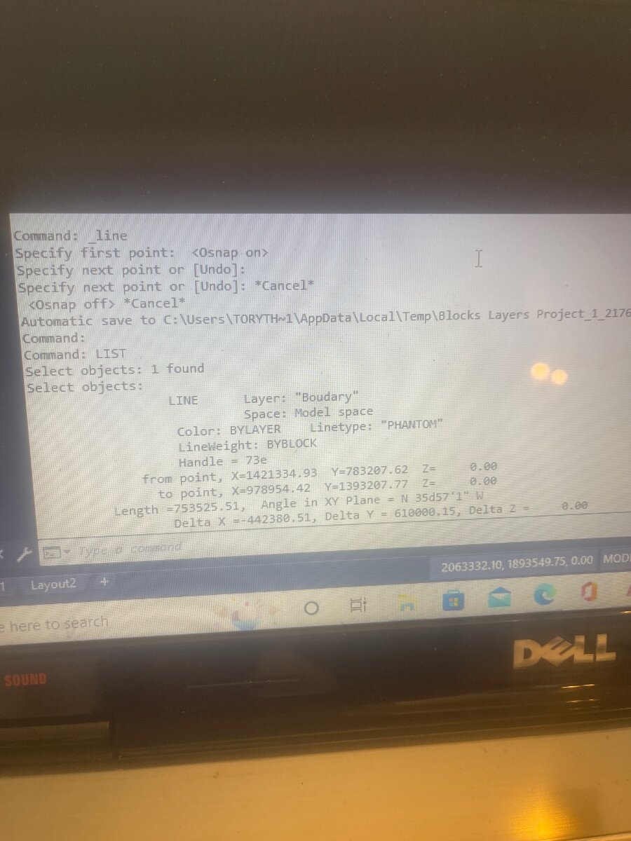

Torbone Posted July 17, 2022 Share Posted July 17, 2022 i drew 1st line and its not 542.16 feet. why? Quote Link to comment Share on other sites More sharing options...
Torbone Posted July 17, 2022 Share Posted July 17, 2022 sht. i forgot reset it. what should it be Quote Link to comment Share on other sites More sharing options...

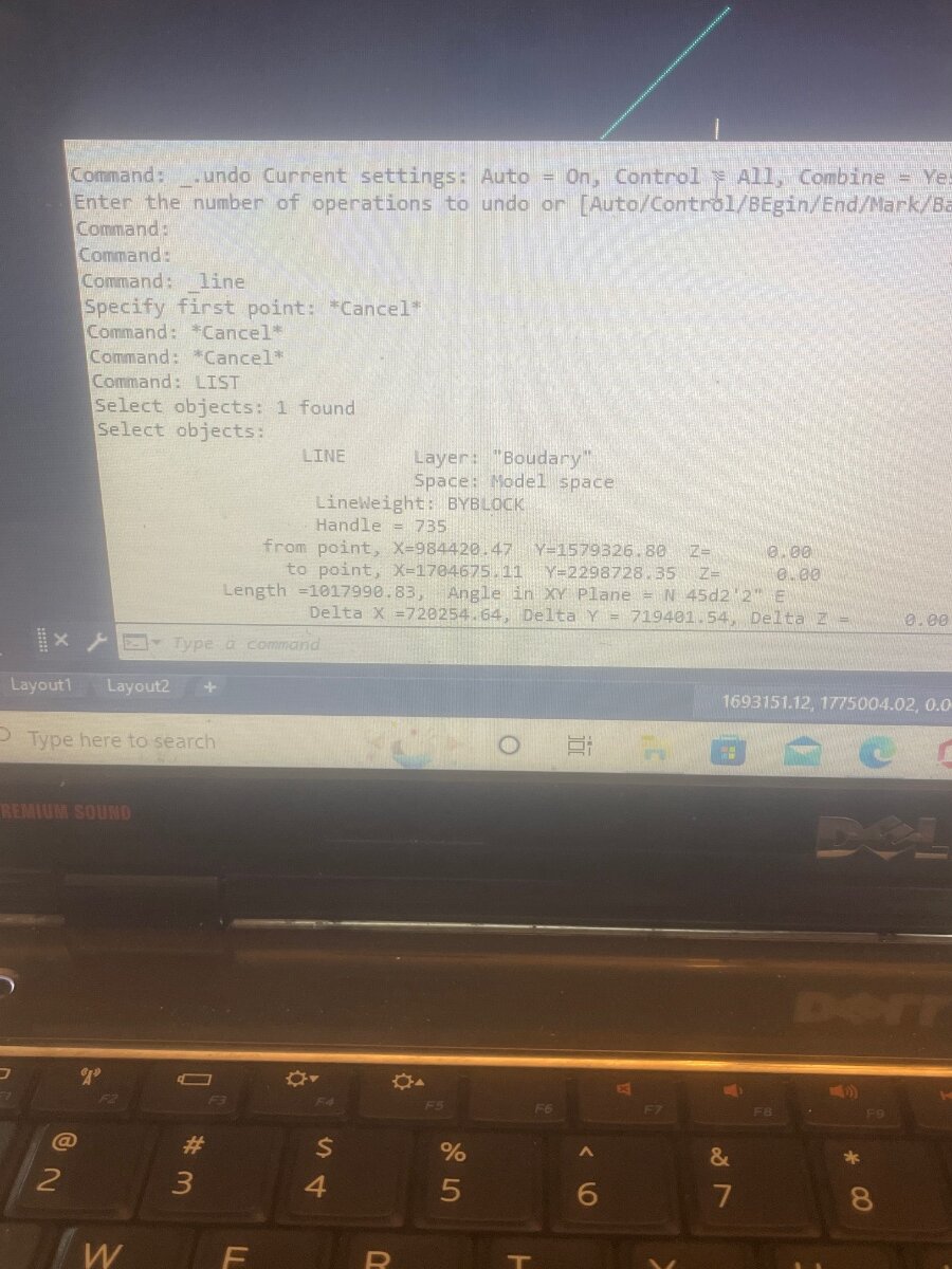

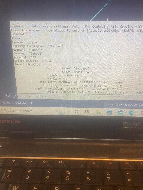

ReMark Posted July 17, 2022 Share Posted July 17, 2022 3 minutes ago, Torbone said: i drew 1st line and its not 542.16 feet. why? You are inputting something wrong. Looking at the information above the line you drew is 1017990.83 feet in length and it was drawn with a bearing of N45D 2' 2"E. Those are both wrong. I'm not even sure how you ended up drawing the line that way. Quote Link to comment Share on other sites More sharing options...

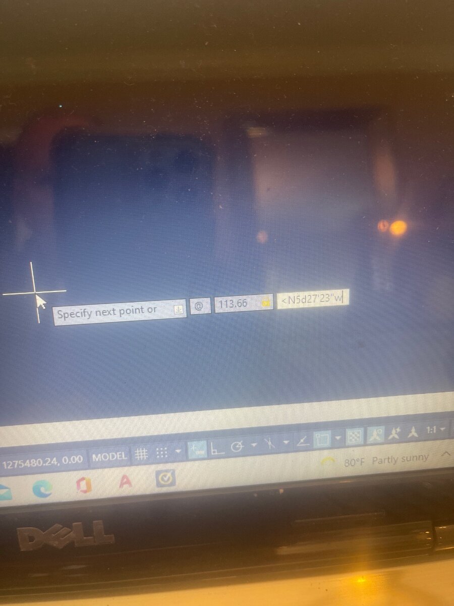

Torbone Posted July 17, 2022 Share Posted July 17, 2022 Here. this is before i hit enter Quote Link to comment Share on other sites More sharing options...

ReMark Posted July 17, 2022 Share Posted July 17, 2022 (edited) OK... so after you have drawn the line and check its Properties what is the Length and the Angle? OK, this wasn't a trick question. Open the Properties palette, click on the line, then refer to the Properties palette and find where the length of line is displayed and the angle at which it is drawn. Should be the same as your input. Edited July 17, 2022 by ReMark Quote Link to comment Share on other sites More sharing options...

Torbone Posted July 17, 2022 Share Posted July 17, 2022 Quote Link to comment Share on other sites More sharing options...
Torbone Posted July 17, 2022 Share Posted July 17, 2022 Do i have to ad the degree symbol when writing cordinates, or just ‘ and “? Quote Link to comment Share on other sites More sharing options...

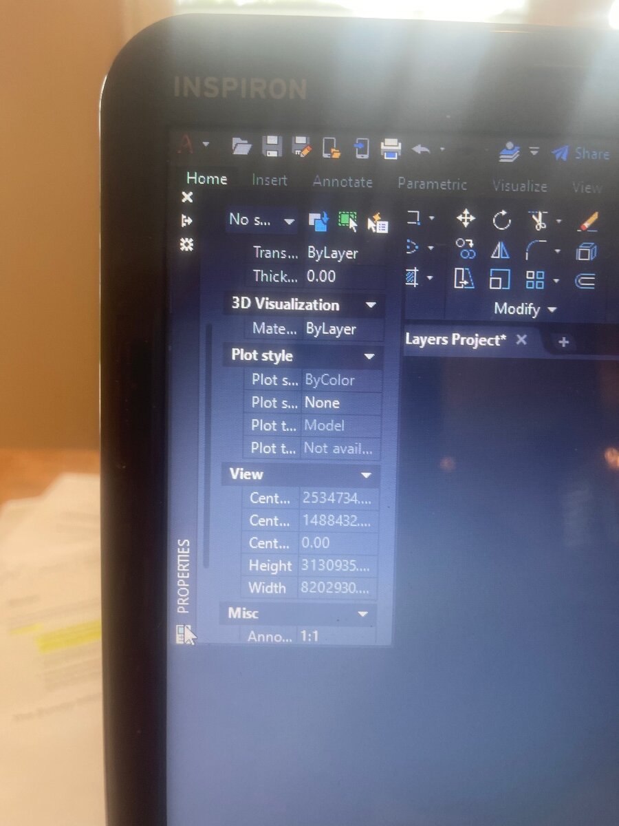

Torbone Posted July 17, 2022 Share Posted July 17, 2022 current thickness, is all zeros Quote Link to comment Share on other sites More sharing options...
ReMark Posted July 17, 2022 Share Posted July 17, 2022 (edited) Please STOP! The instructions for creating the four sided boundary of Oleson Village call for the use of a distance (length) and an angle (expressed as a bearing). They do not call for the use of coordinates. Please verify the length and angle of the line drawn from the benchmark to the POB for me. Thank you. Edited July 17, 2022 by ReMark Quote Link to comment Share on other sites More sharing options...

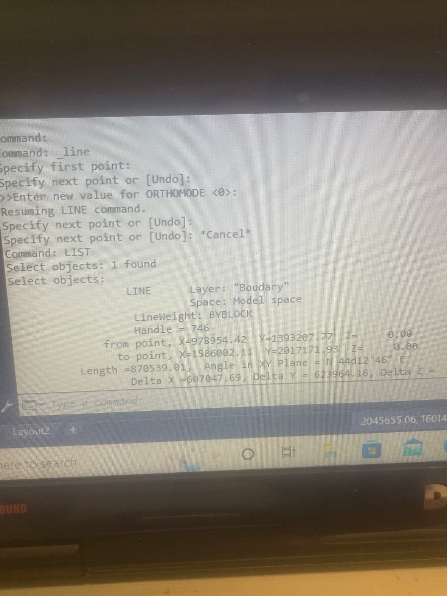

Torbone Posted July 17, 2022 Share Posted July 17, 2022 Why does length read this way- 870539.01? Quote Link to comment Share on other sites More sharing options...

ReMark Posted July 17, 2022 Share Posted July 17, 2022 (edited) 12 minutes ago, Torbone said: Why does length read this way- 870539.01? I don't know. Perhaps you selected the wrong line? What line were you drawing? Edited July 17, 2022 by ReMark Quote Link to comment Share on other sites More sharing options...

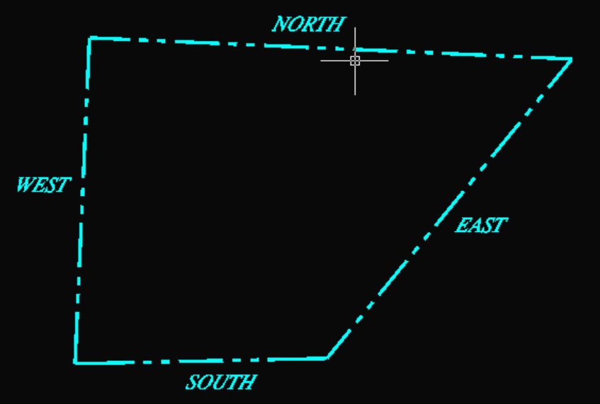

Torbone Posted July 17, 2022 Share Posted July 17, 2022 1 hour ago, ReMark said: This is what your finished boundary should look like. You start by drawing the East boundary first then move counterclockwise. ok i had bench mark wrong. i did not use @ when wrote bearings . Quote Link to comment Share on other sites More sharing options...
