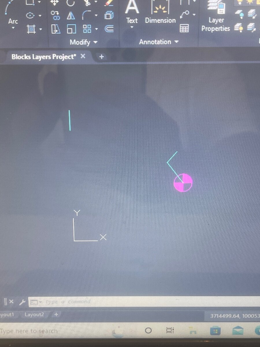

Torbone Posted July 17, 2022 Share Posted July 17, 2022 this is what i drew after benchmark, and all the directions u see here Quote Link to comment Share on other sites More sharing options...
Torbone Posted July 17, 2022 Share Posted July 17, 2022 there is no survey points after, North Boundary line Quote Link to comment Share on other sites More sharing options...

Torbone Posted July 17, 2022 Share Posted July 17, 2022 does what i have look correct? days redoing same commands, and i know its wrong. Quote Link to comment Share on other sites More sharing options...
ReMark Posted July 17, 2022 Share Posted July 17, 2022 Kind of. I'm viewing this on my phone at the moment not my laptop. The line extending from the benchmark to the northwest appears correct but what is the second line going off in a northeast direction supposed to be? Quote Link to comment Share on other sites More sharing options...
Torbone Posted July 17, 2022 Share Posted July 17, 2022 676.62 feet away, N8728’25” North boundary. oleson sub Quote Link to comment Share on other sites More sharing options...
Torbone Posted July 17, 2022 Share Posted July 17, 2022 Do i have to ad the degree symbol when writing cordinates, or just ‘ and “? Quote Link to comment Share on other sites More sharing options...
ReMark Posted July 17, 2022 Share Posted July 17, 2022 You are inputting BEARINGS not coordinates. In AutoCAD they are entered like so.... N15D23'45"W. Use the letter "D" in place of the degree symbol. Quote Link to comment Share on other sites More sharing options...
Torbone Posted July 17, 2022 Share Posted July 17, 2022 omg thats why. ok thanks Quote Link to comment Share on other sites More sharing options...

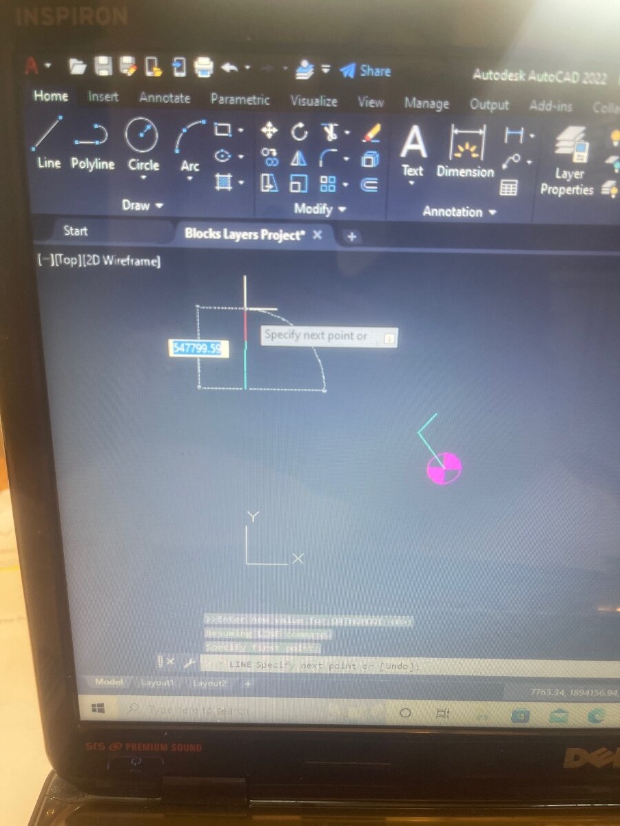

Torbone Posted July 17, 2022 Share Posted July 17, 2022 How long do i draw the North Boundary line? Quote Link to comment Share on other sites More sharing options...
ReMark Posted July 17, 2022 Share Posted July 17, 2022 3 minutes ago, Torbone said: omg thats why. ok thanks By the way, where are you located exactly? I am located in Spartanburg, South Carolina. Quote Link to comment Share on other sites More sharing options...
Torbone Posted July 17, 2022 Share Posted July 17, 2022 Also, i drew rectangle box and border was right where North boundary line was , so i erased it Quote Link to comment Share on other sites More sharing options...
