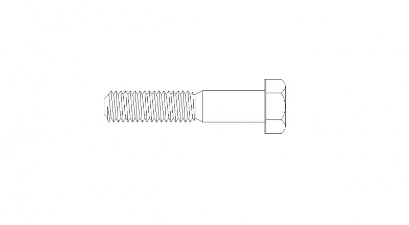

ReMark Posted July 5, 2012 Share Posted July 5, 2012 Is this what you are looking for? Quote Link to comment Share on other sites More sharing options...

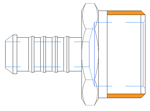

KevinHSH Posted July 5, 2012 Author Share Posted July 5, 2012 Here cou can find my drawing. The drawing is completed, only the thread must me done. The orange colored part must be a screwthread. Quote Link to comment Share on other sites More sharing options...

ReMark Posted July 5, 2012 Share Posted July 5, 2012 The image I posted was extracted from a 3D solid model of a bolt. You are doing your drawing entirely in 2D without the benefit of 3D. Is that correct? Quote Link to comment Share on other sites More sharing options...

ReMark Posted July 5, 2012 Share Posted July 5, 2012 Then I would recommend either a book about technical drawing or do an Internet search on the proper way to draw screw threads. Are we talking metric or inch-sized threads? Right-hand or left-hand threads? Coarse, fine or other? An example of what can be found via an Internet search. This is for an external Acme thread. http://www.wildcatdrafting.com/attachments/145_Detailed_Acme_Threads.pdf Quote Link to comment Share on other sites More sharing options...

JD Mather Posted July 5, 2012 Share Posted July 5, 2012 There are three standards for drawing 2D screws. 1. Simplified - used the most, simply dashed (hidden linetype) representing threads. Drawn in nominal position as drawing in true position would not print distinct lines from OD. 2. Schematic - used less often than simplified, a series of long thin and short thick dashes, again drawn in nominal position. 3. Detailed - used least often than other two methods, generally only used to represent large threads (over 1" or 25mm), particularly in assembly sections or multiple largethreads on a cylindrical part. Consult any standard technical drafting text on this topic (a must for someone educated in this field). Quote Link to comment Share on other sites More sharing options...
KevinHSH Posted July 5, 2012 Author Share Posted July 5, 2012 (edited) Hi, I have found a solution for it. Thanks for all the tips that you give me. It is a great forum! The solution was to search in the ISO-tables to the right dimensions for the screwthread. Then you draw the contour of one thread. With a arrea you make the hole thread. Then you mirror the thread, andn move the lower thread a half of the pas to the right. As last you connect the inner and the outer points of the thread and your done. Below you can see my drawing. I am sure it is not the best solution, but for us it is acceptable. So thanks for all your help! Edited July 6, 2012 by KevinHSH Quote Link to comment Share on other sites More sharing options...
