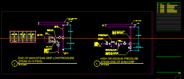

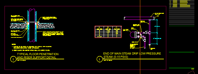

RobDraw Posted September 27, 2012 Share Posted September 27, 2012 Maybe this will help explain my procedure a little better. Although grip editting a locked viewport isn't panning with a little thought, it gives the same result. Notice the position of detail #3 in the images below. What I did was grip edit the viewport to stretch the view to the left. Then shortened it from the right side. Then moved the viewport back to the original position. Quote Link to comment Share on other sites More sharing options...
