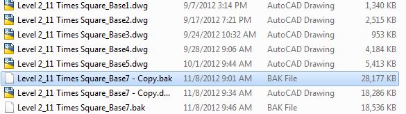

DashaB Posted November 8, 2012 Posted November 8, 2012 So I have this drawing file that has suddenly been growing larger and larger in size. There has not been enough information added to justify such a large increase: Any ideas? (will post more below, my description is too long) Quote
DashaB Posted November 8, 2012 Author Posted November 8, 2012 Now here's the kicker. If i take, for example, base7, which is 18.3MB, and i delete EVERYTHING out of it, run every single purge and audit you can think of, get rid of all layers, all styles, everything, the file is then 18.1 MB. Someone on the Autodesk forum looked into this file for me and said that there was hidden data in there, but i don't know how to get rid of it.. I have tried wblocking everything out, i tried using new files, i've tried just about everything that I could think of, then i looked stuff up online and tried all those things. Nothing will get my filesize down. Here is another fun fact: This same drawing has different file sizes depending on which version i save it down to: 2013: 28.3MB 2010: 28.4MB 2007: 23.5MB 2004: 18.5MB 2000: 190.4MB For now, I am sticking with saving down to 2004 for all my drawings, and that is helping a little bit, but I can't shake the feeling that my files are corrupt and that this problem just will not go away on its own. Other people in my company also have the same problem. These larger file sizes make it take longer to save (this particular file I am referencing takes 16 seconds to save on average) and basic commands like Copy and Paste can take up to 10 minutes per each (10 minutes to copy, 10 minutes to paste into another file). Running audit takes probably 15 minutes, if you're patient enough to wait it out. Please please help me figure out how to get rid of my "hidden" junk. Someone said I have AEC and DGN data, but I haven't been able to figure out how to get rid of this data. Quote

DashaB Posted November 8, 2012 Author Posted November 8, 2012 Why aren't you bringing their information in as an underlay? We bring in their data as an xref, if thats what you mean. Thats what the JobName_base1 is all about; we set up their files, then xref it into our drawing and work primarily in that. Thats why in the one screenprint i posted, there are so many versions - when they send us revised drawings, we set it up as base2, base3, etc.. That way, we can always go back and see what changed. But, please note that the file im having problems with is not our working file with our stuff in it; it is their base, which has no xrefs and no fancy stuff. If i can fix that file, then my working drawing will be faster! And problems solved. BTW EXPORTTOAUTOCAD just finished and the file size stayed the same.. Quote
